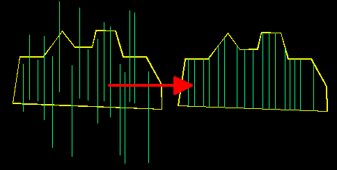

Just need a repeat loop for the lines to be extended or trimmed. Use a ssget to select the objects then.
(if (setq ss (ssget '((0 . "*LINE"))))
(repeat (setq x (sslength ss))
(setq obj2 (vlax-ename->vla-object (ssname ss (setq x (1- x)))))
is obj2 2 a line ?
is obj2 a pline ?

Thank you very much, I also understand your idea, but since I'm new to coding, I need some time to try it again. Whenever you have time, please help me write it if possible. Thanks You!
Try this

Thank you. Let me try to apply it to my lisp,
  On 11/9/2023 at 10:07 PM, BIGAL said:
The posted code on sunday is a working version, did you try it.
I just tried it, andimage.png.4db34dff2d1ca633b2b5da8c37f2207c.png it works great. Thank you!

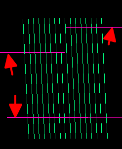

I asked the experts for a bit of help. The Lisp code that Exceed provided me with in the links (Page 1 :  https://www.theswamp.org/index.php?topic=3517.msg391379#msg391379) is excellent, but currently, it only allows me to select one cutting edge at a time. Could you help me modify the code so that I can select two or more cutting edges simultaneously before choosing the lines to trim or extend? Thank you.image.png.fabe65124d6ed771c3d3a0192206bd84.png
The Lisp you provided works fine. I have copied the application to the end of my lisp, the purpose is to cut/pull the lines created from the array (assigned as set ss); Can you help me fix it so that I don't need to re-select the lines (ss) but will receive the lines (in the ss set in the above lisp). I tried the code (according to the photo) but it only cuts/stretches the base line (ss1). Can you watch and help me?

Can you watch and help me? Thanks  you!
Edited by danghungxda300449
This is a different scenario compared to a closed pline etc, so a second program. In the closed shape the end and start points don't matter. To make it work need to check what is say start end of line, this can be done in a few ways. The simplest is to select the line work near the bottom. See green line in image.
You then compare the distance of intpt to the 2 ends and swap if necessary so correct end is moved.
Will add to my to do list. Some one else may supply an answer sooner.
PS use the <> code tags for your posted code.

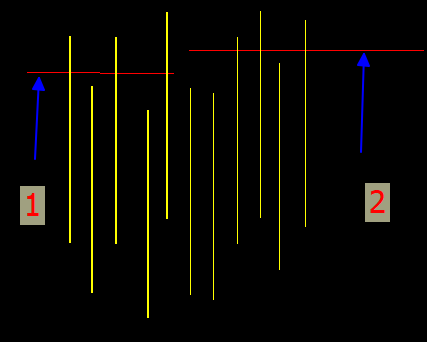

I found on the forums an improved lisp and the purpose I wanted (selecting multiple boundaries). I tried it out and found that Lisp worked, but it wasn't stable, sometimes CAD couldn't cut/extend the lines (it was still the same drawing and the limit line check was a polyline, the lines to be cut were lines). ), I don't know if it's because of the variables or some other reason why the intersection function is unstable? Can you help me look at it and find out the reason to fix it so that Lisp works effectively? Thank you!
*Code lisp:
