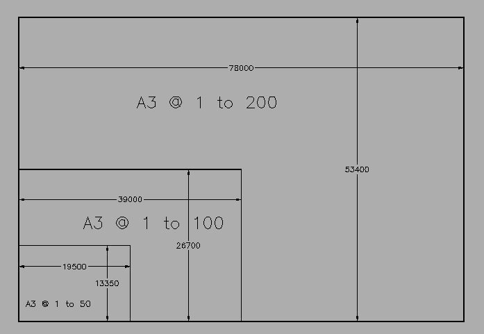

I have started a new job as a lighting designer and they use different methods as can be expected. The only problem is the boss wants it in a 1:50 scale on an A3 PDF as they have an A3 printer. I have tried at 1:50 but it zooms in too large. I've set up the page in 'page setup manager' but still can't get it as 1:50. I personally think it is too big but am I missing something here? I don't have anyone else to ask so don't know if it's just me or not. I'd appreciate any help on this. Thanks

Did you draw everything in model space at FULL size?
Did you draw in using millimeters?
An A3 at 1:50 gives a size of 19.5m by 13.35m. So if the drawing is larger than that, it won't go on an A3 sheet at 1:50.
Time for a larger size piece of paper or a different scale. 1:100? 1:200?

Yes drawn in model space at 1:1 (millimetres).
I think it's too big for a3. I will just tell the boss it will have to be a different scale.

This picture might help you to decide what scale is needed.

Nice visual eldon, that should help the op sort it out! :beer:
