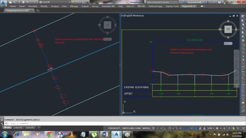

Hello BIGAL,
I attached the image.
Need to add elevations and offset of red circled points.
Thanks for reply.
Chamara

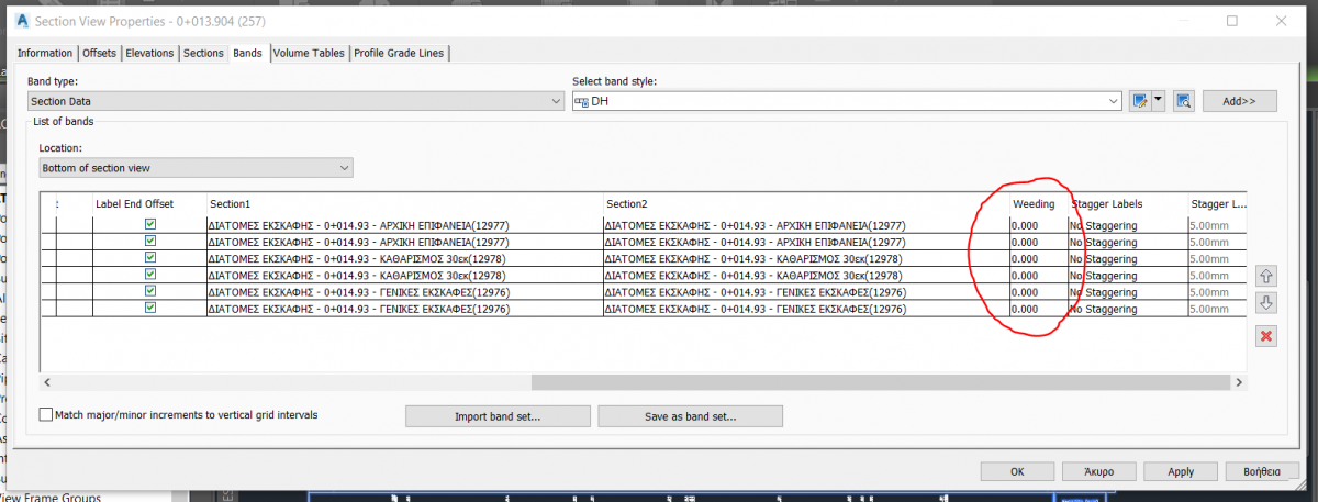

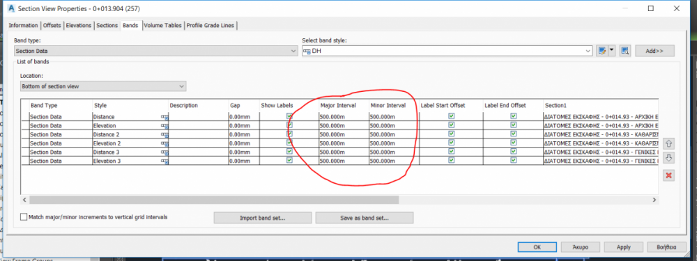

In Section View Properties put the "Weeding" = 0 and you will see the elevations and offset of red circled points. If you want elevations and offset of red circled points ONLY, without any other points,  put "Minnor and Major Interval" a big number, perhaps  greater than the width of section e.g. 500.00m.
