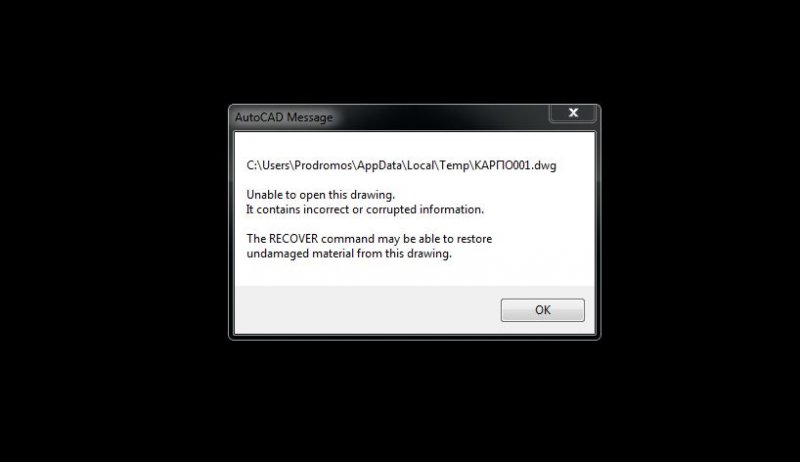

Guest Posted December 4, 2014 Posted December 4, 2014 I try to open one *dwg file from my temp and gives me this message. Is it possible to by pass this message and recover the file if it isnecessary? Thanks Quote

Dana W Posted December 4, 2014 Posted December 4, 2014 Try the Recover command. It does for you what you are trying to do by another method. Quote
Guest Posted December 4, 2014 Posted December 4, 2014 Try the Recover command. It does for you what you are trying to do by another method. Yes i know ,but i have to find the same path again. Is it possible to add a filter in the code and if the file needs recover then open it with the recover command? Thanks Quote

Guest Posted December 5, 2014 Posted December 5, 2014 1) I can't open *.dwg files from my temp file becouse try coppy and rename it and the can not find it ! 2) After the fattal error i open Autocad . Open as Drawing 1 . When i open the renamed *.bak file with this lip root opens as second drawing in autocad. Is it possible to open as current drawing ? There is no reason to stay open the drawing 1 because after fatal error Autocad crash (defun C:bak (/ fn path dwg) ;v1.1 (if (setq fn (getfiled "Select file" (getvar "tempprefix") "sv$;bak;dwg" 2)) (setq path (strcat (vl-filename-directory fn) "\\") dwg (vl-filename-mktemp (strcat (vl-filename-base fn) "_") path ".dwg") fn (if (/= (strcase (vl-filename-extension fn)) ".DWG") (vl-file-copy fn dwg t) dwg ) ;_ end of if ) ;_ end of setq (princ "Failed! *cancel*") ) ;if (terpri) (if path (vla-open (vla-get-Documents (vlax-get-Acad-Object)) dwg :vlax-false)) ;<-- MDI mode (princ) ) ;bak Thanks Quote

Guest Posted December 6, 2014 Posted December 6, 2014 Hi ReMark . I can not understand why you are writing this How many times a day (or a week) does AutoCAD crash? What are you attempting to do when AutoCAD crashes? Are there any error messages and if so what do they say? Do these crashes occur randomly or are they apt to happen at the same point in a drawing session? Can you "force" a crash by executing a particular command? If so, what command would that be? Do these crashes happen no matter what drawing you are working on or only when you are working on a specific drawing (or set of drawings)? What are your system specs? Have you installed any/all service packs for your version of AutoCAD? What have you done to troubleshoot the problem so far? What other programs are running in the background as you are working in AutoCAD? Are you hooked up to a network or is this a standalone workstation? Are you interested in getting to the root cause of the problem? I am not trying to crash my autocad ,but many times when i do right click in Mtext editor and paste a text gives me fatal error an lose all the job. I didn't know that in the temp file i can find a bak file , so i draw from the beginning or from the last save. This post is important for me and thank you for the help. Quote

SLW210 Posted December 8, 2014 Posted December 8, 2014 I'll also ask, what is the exact error message? Also, what Graphics Card and Driver are you using? Specs of the computer? What OS? 32-bit or 64-bit? If possible answer all of ReMark's questions, but at least answer these. Also, if you would be diligent in using Ctrl+S (Save) your need in all of those other files would be non-existent. One would believe that solving your crash problem would trump a workaround. Quote
Guest Posted December 8, 2014 Posted December 8, 2014 I have graphic card ATI Radeon HD 5570 My pc is AMD Athlon II X4 640 Processor 3.00 GHz RAM 8.00 GB win7 Ultimate 64 bit SP1 Quote
SLW210 Posted December 8, 2014 Posted December 8, 2014 Do you have the latest driver? I do not see that Graphics card on AutoCAD recommended list, maybe I missed it. His hardware acceleration on or off? Quote
Guest Posted December 8, 2014 Posted December 8, 2014 I do all the updates for the drivers. I have seen a lot of times this fatal error when i do wright click in mtext editor and when i try to bind something (not all the times ). Quote
