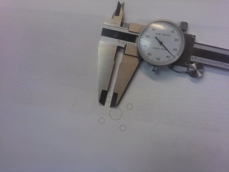

Hey guys need help I can not print my sketch to real scale on A4 paper? I've tried setting plot and played with scale setting(1:1 etc) no luck. By the way I'm using cadiso template here I have an attached image but dunno how to attached dwg file. can anyone show me to what I'm doing wrong ?
much appreciated
James.
I managed to print it 1 to 1. 1st I copied the drawing into a new drawing, then I used the scale command (SC) and selected everything. After I selected the base point when prompted to enter the scale factor I use a almost forgotten command 'CAL. For the expression I entered 1/25.4, hope this helps. I have never tried to do a 1 to 1 print in millimeters, I'm not saying it can't be done, just not by me ATM.
Hey zaphod cheers for that. but I'm still having trouble following this part of your instruction

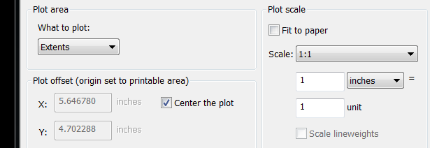

For the little bit of work you've done in the 6mm.dwg attached to one of your previous posts I'd just start over and make sure to use a metric template. I suggest using the acadiso template. By default, since AutoCAD is a U.S. product, the acad.dwt template file is used when starting a new drawing and it is set up to utilize decimal inches. Got it?
There is one other option available to you. Type -dwgunits at the command line (yes, including the dash). Now you are given the chance to change your drawing units from (meaning decimal inches) to (meaning millimeters). You'll want to respond "Yes" to the questions that are asked before the command terminates. If you take this approach your objects may disappear from your screen. Don't worry, they were not deleted. They are just off-screen at the moment. Execute a Zoom > Extents and your objects will once again be visible. You're good to go now.
Edited by ReMark
Here is a snip from autocad as to how I scaled it.

Tried your method using acadiso template, in command type -dwgunits follow the option. than click on print, did window select change scale to 1;1 steal not getting real scale on printed paper, man this is doing my head in.
