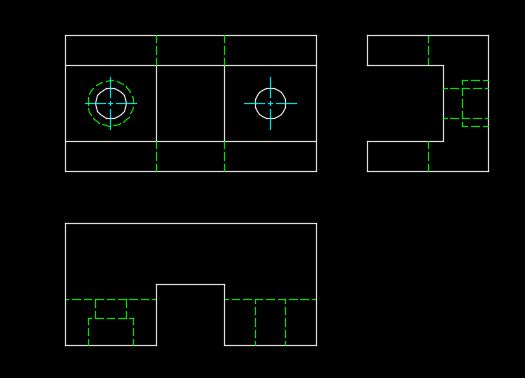

its true ??

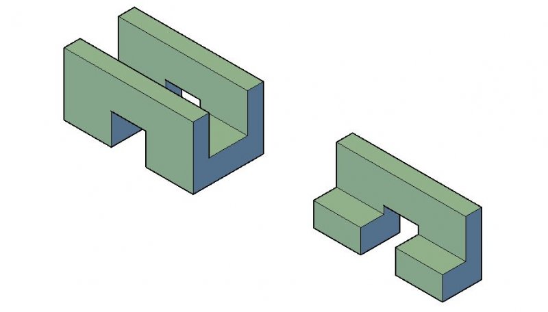

Your front and side views don't look exactly like what is pictured in post #1.
Your top view is incorrect and your dimension text height is a bit too small .
There is also an extra line on the right hand side of your top view to the left of the circle.
How did you get a dimension of 412,63 for the length? Isn't it supposed to be 4.12?
Are all views supposed to be fully dimensioned for this exercise?
Does anyone else here think this exercise was meant to be done in decimal inches as opposed to millimeters?
Edited by ReMark
Your three views should look like this.
Keep in mind that the opening seen in the front view passes all the way through.
For demonstration purposes only. The 3D model is incomplete (no holes).
On the left we see the two channels cut through the object (front-to-back & side-to-side).
On the right is a section created using the Slice command. See how the opening that passes through the object from front to back partially cuts into the vertical leg?
Now do you understand what is happening and how to show it in the top view?

The drawing is in milimeters, and the dimension text is 2.5 mm tall. The right to left measurement of the object is 412 mm, not 4.12" as it should be according to the example plate from the lesson. Apparently it should have been drawn in inches from the start.
PEy9z7.png ????
It is dashed because it is below the surface that you can see. It would not be shown using a continuous line.
