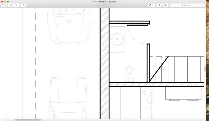

I'm fairly new to cad, been using it for less than a year but have never had this problem before: when i export a dwg file to pdf not all the lines appear... it is not a layer issue as some of the missing lines are in the same layer as those that are showing up. if you zoom in to the pdf they will appear but i have quality issues when plotting. i don't think it's the drawing because if i use autocad on the windows side of my mac it is fine although appears to be exporting faintly - blacks are more grey in colour. so i am assuming it's some sort of bug on autocad for mac? i had 2014, deleted it and upgraded to 2015 but have the same issue. i've upgraded to yosemite but the drawing was fine after this, it has only happened in the last few days. please help, my final crit is in 2 weeks!

did you found a solution ? i'm having the same problem, lines appear only when you zoom A LOT in

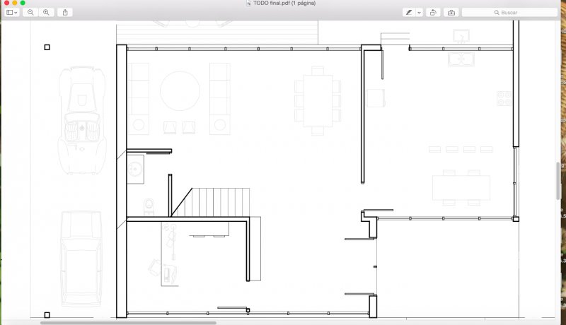

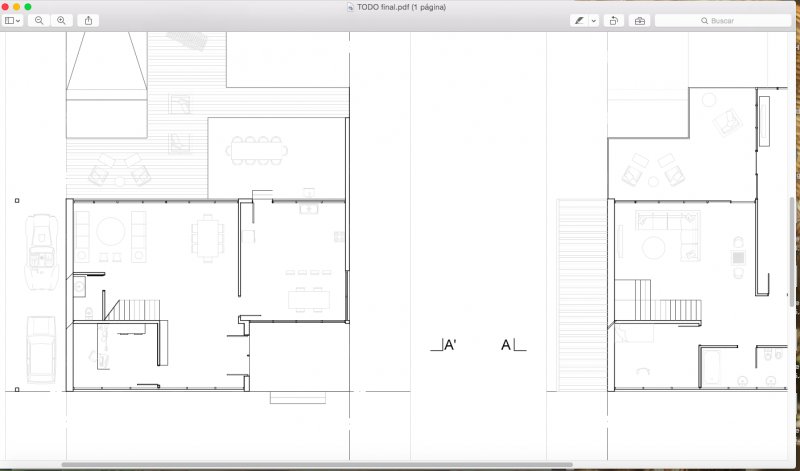

Okay, so here it is. I'm using Mac AutoCad 2015. I've always used it and i've never have this problem. I usually export pdfs from the layout, using a ctb which i cannot attach (invalid file), but it happens when i use black continous lines in 0.00 or 0.05. The result on pdf looks very pale and lots of lines do not appear. As you zoom in, lines begin to appear, and they all appear just at 200% or more...
I would not expect a linewidth of 0.00 to even plot and 0.05 would be barely visible unless magnified. Have you tried heavier lineweights?
These line weights are simply below the hardware capability of your display screen to show at their actual width, so they are shown as a sort of proxy ghost thingy until you zoom in to a level where the lines are actually as big or bigger than one physical display screen pixel. Look at a white portion of your computer screen with a strong magnifying glass. You see a grid. If the line width is not as big as one square in that grid, it will not trigger a pixel on or off.
EDIT: I almost forgot. Your video card is also probably having brain cramps. PDF and plot preview are HUGE graphics memory hogs.
Edited by Dana W
Oh, they'll probably plot, but the driver will default them to the lower limit of the hardware capability of the print head. This gives the result of all the very thin lines below the hardware limit having the same width.
Now pdf viewers and AutoCad plot preview are entirely different. They will let you zoom out until you run out of enough width to light up a pixel. The OP is seeing pretty much normal behavior with these line weights.
