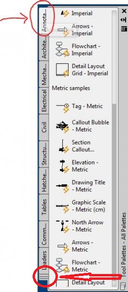

Sengna Posted November 20, 2014 Share Posted November 20, 2014 I tried to help a friend of mine who is using Autocad 2010 LT. I could not find the annotative tab under tool pallet. Does anyone know how to import the annotative in his autocad? Because that where i can get the section callout. or Is there any other way to get the section line symbol beside draw it out using multi leader? Thanks This Screenshot is from 2014 Autocad Quote Link to comment Share on other sites More sharing options...

ReMark Posted November 20, 2014 Share Posted November 20, 2014 It should be on the Annotation tab shown in the graphic. Did you try using the slider bar on the right to see what is higher up on that tab? Quote Link to comment Share on other sites More sharing options...
SLW210 Posted November 20, 2014 Share Posted November 20, 2014 It should be on the Annotation tab shown in the graphic. Did you try using the slider bar on the right to see what is higher up on that tab? Did you read the entire post? Or maybe you just haven't had enough coffee yet? The Image is not from the 2010 AutoCAD he is looking for the Palette, but from 2014 AutoCAD that shows the Palette the OP is looking for on a friends computer. C:\Users\[i]YourName[/i]\AppData\Roaming\Autodesk\AutoCAD 2XXX\RXX.x\enu\Support\ToolPalette\Palettes Is where they are found initially, but you can look in Options>Files>Tool Palettes File Locations for all paths to them. See if this helps...http://www.ellenfinkelstein.com/acadblog/easily-share-tool-palettes-with-colleagues/ You can click at the bottom and should see all available palettes. Quote Link to comment Share on other sites More sharing options...

Sengna Posted November 20, 2014 Author Share Posted November 20, 2014 If that fails, It's right here in this dwg. You can also use the design center, on the insert tab. Use the Folders tab in the design center to navigate to Windows\Program Files\AutoCad LT 2010\Sample\en-us\Dynamic Blocks\Annotation-Imperial.dwg\blocks... (or something similar) . Thanks Dana, we followed the path on his computer per your suggestion, we found it now. after we went back to tool pallets, we found the Annotation tab and the section line callout was there. It was wierd that it didn't show the first time. Thanks Quote Link to comment Share on other sites More sharing options...
Sengna Posted November 20, 2014 Author Share Posted November 20, 2014 C:\Users\[i]YourName[/i]\AppData\Roaming\Autodesk\AutoCAD 2XXX\RXX.x\enu\Support\ToolPalette\Palettes Is where they are found initially, but you can look in Options>Files>Tool Palettes File Locations for all paths to them. See if this helps...http://www.ellenfinkelstein.com/acadblog/easily-share-tool-palettes-with-colleagues/ You can click at the bottom and should see all available palettes. SLW210 , after we navigated through the path via program file, we finally found the all the dynamic blocks and found the annotation tab on the tool pallets afterward. Thank you very much. Quote Link to comment Share on other sites More sharing options...
Dana W Posted November 20, 2014 Share Posted November 20, 2014 Thanks Dana, we followed the path on his computer per your suggestion, we found it now. after we went back to tool pallets, we found the Annotation tab and the section line callout was there. It was wierd that it didn't show the first time. ThanksHover the cursor over the bottom or top edge of the pallet box until you get the little Window stretcher double headed arrow and make it longer, so more tabs show. Quote Link to comment Share on other sites More sharing options...
Sengna Posted November 20, 2014 Author Share Posted November 20, 2014 That was my thought, that the pallet is simply not selected for display, or it is not expanded enough to see it. At any rate, if the OP comes back they have the block and some suggestions on how to find the missing pallet. That's right, i got it, much easier..........you guys are so smart, thank you Quote Link to comment Share on other sites More sharing options...
