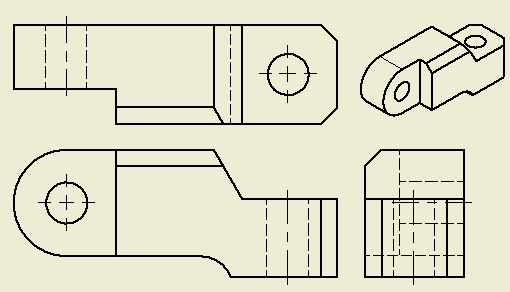

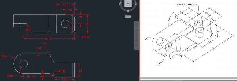

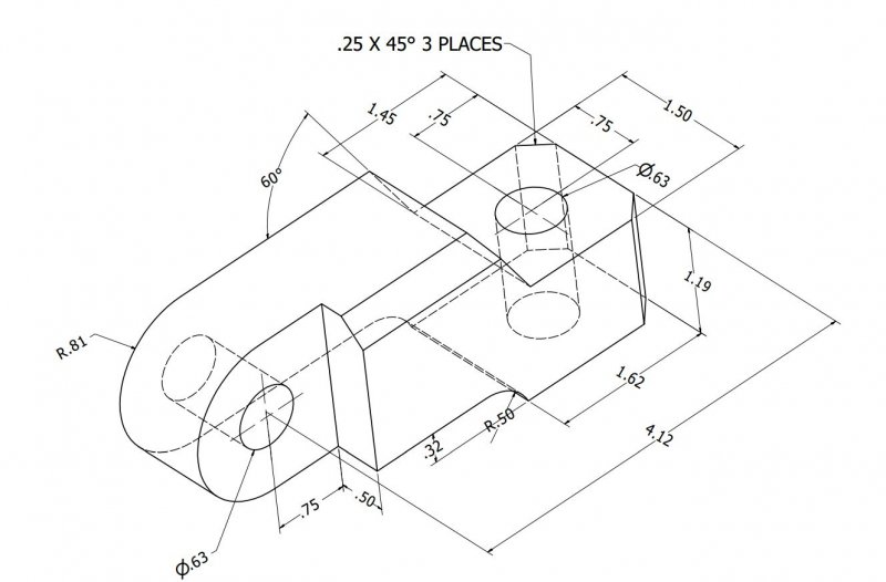

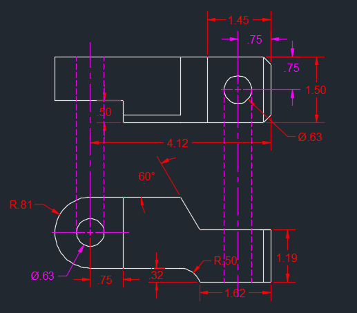

What am I missing/ did wrong?
The hidden lines for the holes are missing and the top view shows an unnecessary line indicating a chamfer that doesn't exist on that surface, but my eyes are not good enough to tell much more. If you want a proper critique, upload a better resolution image of the assignment, and attach your actual drawing file.
This is just to prompt you to find corrections.
I think I am missing one other line.
If you did this as 3D - you could be sure the solution was correct.

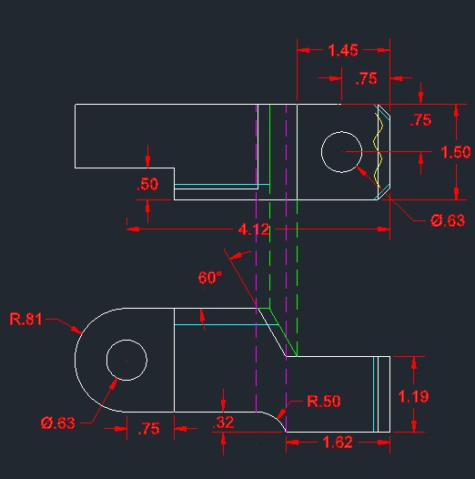

In addition to what JD has already pointed out:
1) in the side view, you have the 60degree angle beginning at 1.62 from the right edge when it should be 1.45 as you have correctly drawn on the top view. This of course also affects the top of the 60degree angle (green)
2) There should not be a line between the chamfers on the top view. (yellow)
3) I believe the (3) chamfers should be .25x.25, not .25 across the face of the chamfer (cyan)
4) At least one of the R.50 edges should be seen as a hidden line on the top view (magenta)

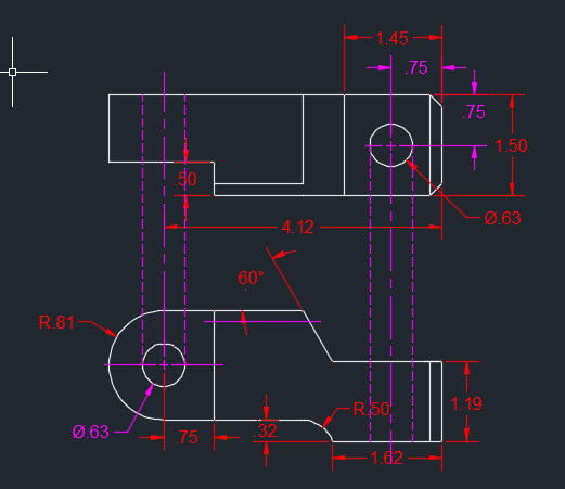

Thanks for the help guys, I was able to figure everything out. And sorry for the really late reply, I was busy and didn't have the chance to work on it.
