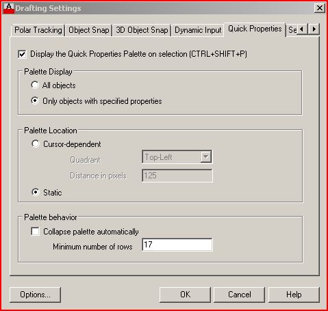

Dadgad Posted November 19, 2014 Posted November 19, 2014 (edited) Quick Properties doesn't seem to have any trouble with it, but it shows less information. Mostly i only need it to edit text height or arrow sizes. Perhaps if i set the right filters it's better. It needs a lot of configuring for all the objects, is it exportable? Can i save the .cui or something file for the quick properties settings? As with any sort of customization, it will take a little effort, five to ten minutes invested working through the list. At the end of that exercise however you will have a quicker and more relevant tool at your disposal. There are a number of setting options for the display of the Quick Properties palette, as shown in the screenshot. You have the option of only choosing the info to display for the types of objects which are most applicable in your use. In that case you would probably want to display properties for "only objects with specified properties". The palette can be self collapsing, or not, and static or cursor-dependent. I use it all the time, would be lost without it. It saves me having to wade through a lot more information, on the fly, than I typically need. Edited November 19, 2014 by Dadgad Quote
