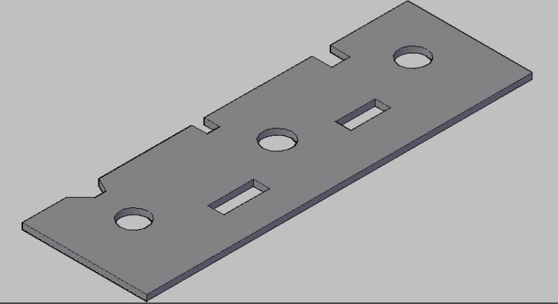

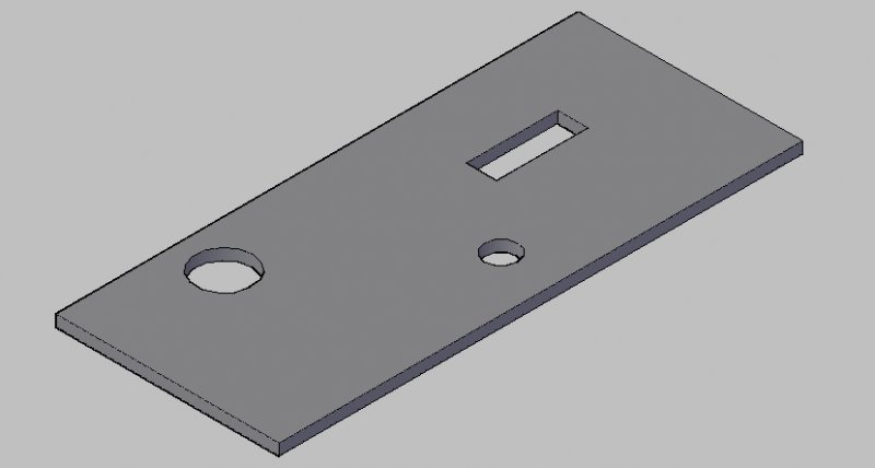

magan Posted November 16, 2014 Posted November 16, 2014 Hello everyone. I am currently using AutoCAD2014. I am trying to code the program using AutoLISP. I am having 3D solid with some holes. I want to get the center of the circular hole and (length-width) of rectangular hole. and the output data has to be printed in the command prompt of autoCAD as output. This is all to be done with just single click on object. I am here providing the image of my object as well. Please, someone help me. Quote
BIGAL Posted November 17, 2014 Posted November 17, 2014 Maybe copy object to somewhere explode twice you can find circles but rectang becomes lines a bit of smart coding would reveal LxW use bounding box of 3d solid for limits and copy a known amount so you can work out object cen pts etc. use (ssget (assoc 0 "Circle,Lines")) Lee-mac posted a possible solution for this http://www.cadtutor.net/forum/showthread.php?35506-How-to-get-Region-coordinates/page2 Quote

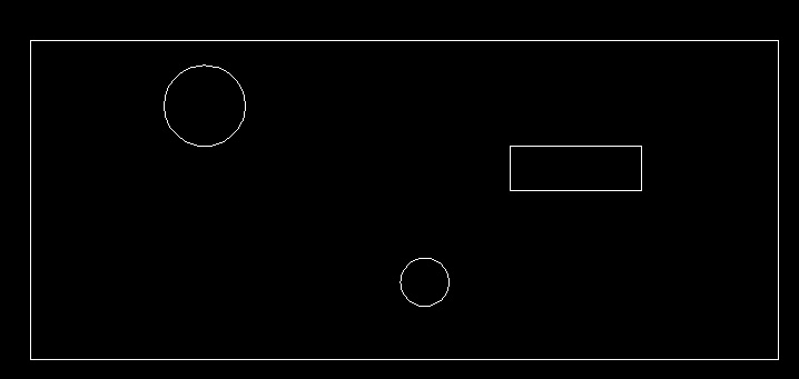

magan Posted November 17, 2014 Author Posted November 17, 2014 Thank you for the help, But,I don't know what is the reason it's not working. Let me make this problem easy.I will initially work in the 2D of this component. If this 2D component is blocked as one. And then if I want centres of circles and (length-width) of rectangle, what can be done? Please help me. Quote

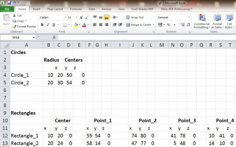

amili Posted February 7, 2015 Posted February 7, 2015 Thank u so much sir,,,, It is so special for me that I cannot explain it to you. Again thank you sir. If you dont mind I want to ask you some more question regading my work. As what have been done with the circular holes, can it be done with the rectangular holes? IF yes then I will have to get the following data from that rectangle: 1. Center of the rectangle 2. Points of the rectangle 3. And Length , width of the rectangle. For your refernce, I am attaching screenshot of my drawing as well as expected output excel file. It will be very much fortunate for me if these can be done with Autolisp. Please help me. Quote
sonali Posted March 3, 2015 Posted March 3, 2015 Hey Amili.... Your problem is solved, thanx to hanhphuc and lee-mac. In the post # 6, replace the AcDbCircle with AcDbPolyline. But, hanhphuc , I want to ask you one thing that, the data file which is generated continuously saves previous data, though the file is deleted. So, some previous garbage values are collected in the data fie. I want to remove those unnecessary values. Can you help in this regard?? Quote
