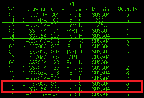

Maybe this ?
Sorry !Master Tharwat, Not this! Thank you for your patience to help me !
I don't need the same drawing number change color at the same time , if 3 or 4 drawing number is the same , Harder to resolve. so I don't need this .
After this time you modify, The same PARTNAME can't changed color .
Let me think about it. Maybe I need someone help me translate my thoughts.
Please wait a moment . Master Tharwat,Thank you for your patience to help me !
I modified the codes in Post 41 try it and let me know .
Thank you so mush! Master Tharwat, I' m sorry ! I'm still waiting for a friend to help me translate.
You can test this document frist.
TEST1.dwg
[ATTACH]51647[/ATTACH]
Why you are re-uploading the same file as you have uploaded in your first post ?
NO,is not same, I changed drawing name .
Is like this ,Isn't it
No highlight, is that right ?
Which number of rows in that schedule you think it should be highlighted ?
13 and 14 , Because, "030" Repeat.
That is why I said only check last three digits
Try it now , I modified the codes in Post # 41
That was for showing the date in sequence and not for coloring if any of them have the same values as you have declared before .
hi Tharwat as usual you are so helpful :)
Format text by {\\C1 } so simple other than rgb method :thumbsup:
my understanding OP wants to highlight either 1 of 2 duplicates for specified cell which refer to ONLY the last 3 digit of dwg No: eg: 1-SS706A-030
ie: if 2 are same than just highlight 1 of the cell ,not all cells.
i'm not sure whether hitTest function helps? which OP can highlight himself?
Master Tharwat, Thank you for your patience to help me
This is what I want ,very nice!!! beautiful !!!:D
You should get "Forum Help Award" :thumbsup:
why you add *hgt* into the Local variables? So, need to input Text Height every time . I remove it ,It seems no err.:roll:
hanhphuc ,Thank you for help!
Thank you hanhphuc :)
I guess that's what I did with my last modify to codes .
It is time to say WAW :lol: and thanks for the nice words :)
Opps :shock: you are right , actually that variable hgt and I replace it with *hgt* to be global by the Replace command in Vlide and I did not notice it localized , so I will erase it from localized variables .
Good luck .
Tharwat

                    (atoi (substr (setq st (cadr i)) (- (strlen st) 2))
      (or acdoc
          (setq acdoc (vla-get-activedocument (vlax-get-acad-object)))
      (setq c   6
            r   2
            inc -1
            tbl (vla-addtable
                  (vla-get-modelspace acdoc)
                  (vlax-3d-point (trans pt 1 0))
                  (+ (length l) r)
                  c
                  (* *hgt* 2.5)
                  (* *hgt* 2.5)
      (if (tblsearch "LAYER" "dim")
        (vla-put-layer tbl "dim")
      (mapcar
        '(lambda (h) (vla-setcolumnwidth tbl (setq inc (1+ inc)) h))
        (mapcar '(lambda (x) (* *hgt* x))
                '(5. 12.5 7. 7. 7. 10.)
      (setq inc -1)
      (repeat (+ (length l) r)
        (vla-setrowheight tbl (setq inc (1+ inc)) (* *hgt* 1.2))
      (defun _settext (c st)
        (vla-settext tbl r c st)
        (vla-setcelltextstyle tbl r c "SIMPLEX")
        (vla-SetCellTextHeight tbl r c *hgt*)
        (vla-setcellalignment tbl r c acMiddleCenter)
        (vla-setrowheight tbl r (* *hgt* 1.2))
      (setq r 0)
      (_settext 0 "BOM")
      (setq r 1)
      (mapcar '_settext
              (list 0 1 2 3 4 5)
              '("NO." "Drawing No." "Part Name" "Material" "Quantity"
                "Date"
      (setq r  2
            c  0
            i  -1
            in -1
      (foreach v l
        (foreach it (append (mapcar 'car l) (mapcar 'cadr l))
          (if (or (eq (substr it (- (strlen it) 3))
                      (substr (cadr v) (- (strlen (cadr v)) 3))
                  (eq it (car v))
            (setq y (cons it y))
        (if (> (length y) 2)
          (setq wrt (list (strcat "{\\C1;" (cadr v) "}")
                          (strcat "{\\C1;" (car v) "}")
                          (strcat "{\\C1;" (caddr v) "}")
                          (strcat "{\\C1;" (nth 3 v) "}")
                          (strcat "{\\C1;" (nth 4 v) "}")
                red t
          (setq wrt (list (cadr v) (car v) (caddr v) (nth 3 v) (nth 4 v))
                red nil
        (setq y nil
              i (1+ i)
        (if (< i 10)
          (setq nu (strcat "0" (itoa i)))
          (setq nu (itoa i))
        (_settext
          c
          (if red
            (strcat "{\\C1;" nu "}")
            nu
        (foreach txt wrt
          (_settext (setq c (1+ c)) txt)
        (setq c 0
              r (1+ r)
)(vl-load-com)
Hi Andy , Happy to hear from you again :)
I am sorry I did not reply to your PM because I was busy this morning and after seeing your request here , I decided to reply to your request here .
So, try this modification and let me know .
Hi Master Tharawt.
Don't say sorry . You are my benefactor :)
Ok now , I saw the change
add
and
if I need add more attribute. so do it like this ?
(strcat "{\\C1;" (nth 5 v) "}")
(strcat "{\\C1;" (nth 6 v) "}")
(setq wrt (list (cadr v) (car v) (caddr v) (nth 3 v) (nth 4 v) (nth 5 v) (nth 6 v))
Yeah , and don't forget about the column quantity and the head title besides that the tag name as well .
:) I know! Thanks :beer:
