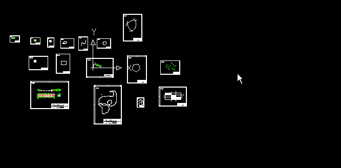

Tharwat Posted November 15, 2014 Posted November 15, 2014 (edited) Try this and let me know how you would get on with it . (defun c:Test (/ ss hgt pt n i sn tg lst l c r inc tbl st dups pns wrt nu) ;; Author : Tharwat Al Shoufi ;; ;; Date : 15. November. 2014 ;; ;; Write a special kind of attributes to AutoCAD table ;; (if (and (if (tblsearch "STYLE" "SIMPLEX") t (progn (alert "Text Style < SIMPLEX > is not found in Drawing !") nil ) ) (princ "\n Select named blocks < TitleBar > :") (setq ss (ssget '((0 . "INSERT") (66 . 1) (2 . "TitleBar")))) (setq *hgt* (cond ((getdist (strcat "\n Specify Text Height < " (if *hgt* (rtos *hgt* 2 2) (rtos (setq *hgt* 1.0) 2 2) ) " > :" ) ) ) (*hgt*) ) ) (setq pt (getpoint "\n Specify Base Point of Table :")) ) (progn (setq hgt *hgt* n -1 ) (repeat (setq i (sslength ss)) (setq sn (ssname ss (setq i (1- i)))) (mapcar '(lambda (x) (if (or (eq (setq tg (strcase (vla-get-tagstring x))) "DRAWINGNO." ) (eq tg "PARTNAME") (eq tg "MATERIAL") (eq tg "QTY") ) (setq lst (cons (vla-get-textstring x) lst)) ) ) (vlax-invoke (vlax-ename->vla-object sn) 'getattributes) ) (setq l (cons lst l) lst nil ) ) (setq l (vl-sort l '(lambda (n i) (< (atoi (substr (setq st (cadr n)) (- (strlen st) 2)) ) (atoi (substr (setq st (cadr i)) (- (strlen st) 2)) ) ) ) ) ) (or acdoc (setq acdoc (vla-get-activedocument (vlax-get-acad-object))) ) (setq c 5 r 2 inc -1 tbl (vla-addtable (vla-get-modelspace acdoc) (vlax-3d-point (trans pt 1 0)) (+ (length l) r) c (* hgt 2.5) (* hgt 2.5) ) ) (if (tblsearch "LAYER" "dim") (vla-put-layer tbl "dim") ) (mapcar '(lambda (h) (vla-setcolumnwidth tbl (setq inc (1+ inc)) h)) (mapcar '(lambda (x) (* hgt x)) '(5. 10.5 7. 7. 7.) ) ) (setq inc -1) (repeat (+ (length l) r) (vla-setrowheight tbl (setq inc (1+ inc)) (* hgt 1.2)) ) (defun _settext (c st) (vla-settext tbl r c st) (vla-setcelltextstyle tbl r c "SIMPLEX") (vla-SetCellTextHeight tbl r c hgt) (vla-setcellalignment tbl r c acMiddleCenter) (vla-setrowheight tbl r (* hgt 1.2)) ) (setq r 1) (mapcar '_settext (list 0 1 2 3 4) '("NO." "Drawing No." "Part Name" "Material" "Quantity") ) (setq r 2 c 0 i -1 ) (foreach v l (if (or (member (cadr v) dups) (member (strcase (car v)) pns) ) (setq wrt (list (strcat "{\\C1;" (cadr v) "}") (strcat "{\\C1;" (car v) "}") (strcat "{\\C1;" (caddr v) "}") (strcat "{\\C1;" (nth 3 v) "}") ) red t ) (setq dups (cons (cadr v) dups) pns (cons (strcase (car v)) pns) wrt (list (cadr v) (car v) (caddr v) (nth 3 v)) red nil ) ) (setq i (1+ i)) (if (< i 10) (setq nu (strcat "0" (itoa i))) (setq nu (itoa i)) ) (_settext c (if red (strcat "{\\C1;" nu "}") nu ) ) (foreach txt wrt (_settext (setq c (1+ c)) txt) ) (setq c 0 r (1+ r) ) ) (princ) ) ) (princ) ) Edited November 16, 2014 by Tharwat Quote

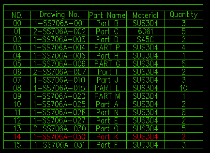

Tharwat Posted November 16, 2014 Posted November 16, 2014 Lots of changes considered in the above modified lisp routine , so try it and let me know . CODES UPDATED ABOVE. Quote
andy_lee Posted November 16, 2014 Author Posted November 16, 2014 Lots of changes considered in the above modified lisp routine , so try it and let me know . CODES UPDATED ABOVE. Master Tharwat, I appriciate your help! Thank you for your effort. Near perfect! DRAWING NO.duplicate Can identify .But PARTNAME duplicate can't identify. Quote

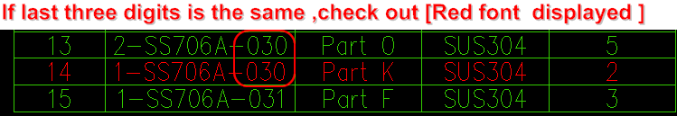

andy_lee Posted November 16, 2014 Author Posted November 16, 2014 updated again. I hope only check last three digits , can do ? Quote

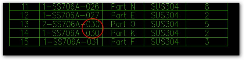

andy_lee Posted November 16, 2014 Author Posted November 16, 2014 Really ? what does the routine do then ? Master Tharwat, the routine is very difficult to do it ? Previous, must "DRAWING NO " is exactly the same , can check out , But two DRAWING NO is 1-SS706A-030 & 2-SS706A-030, It is not allowed in ERP. Quote

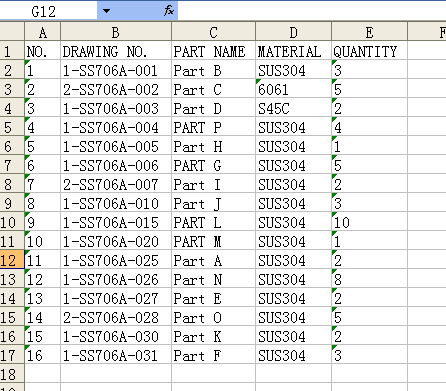

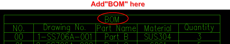

andy_lee Posted November 16, 2014 Author Posted November 16, 2014 Settle all your things of the program up first then write them all here clearly , otherwise I can not keep on guessing which is right and suitable for your needs . I'm so sorry! sorry for my english. Master Tharwat. your routine has reached 99.7% , 0.1 0.2 0.3 If possible ,at last( after insert table), Deciding whether to output to xls(or csv) This picture explaining what i mean. Hope that would be clearer. Thanks so much! Master Tharwat. Quote
Tharwat Posted November 16, 2014 Posted November 16, 2014 01 : do you want to avoid including the duplicate drawing number into the table ? Show me with a sample drawing Before and After with the outcome you want . 02 : easy to add the BOM . 03 : you can export contents of any AutoCAD Table to Excel if you right click on the table and chose export ... Quote
andy_lee Posted November 16, 2014 Author Posted November 16, 2014 01 : do you want to avoid including the duplicate drawing number into the table ? Show me with a sample drawing Before and After with the outcome you want . The DRAWING NO "2-SS706A-030" and "1-SS706A-030" ,the last(end) three digits is the same ! so need Red font . This is the right. 02 : easy to add the BOM . 03 : you can export contents of any AutoCAD Table to Excel if you right click on the table and chose export ... Great!!! Quote
Tharwat Posted November 16, 2014 Posted November 16, 2014 So you want the last two rows to be in red since there are with the same Drawing No. ? Quote
andy_lee Posted November 17, 2014 Author Posted November 17, 2014 So you want the last two rows to be in red since there are with the same Drawing No. ? you are right . row 13 and row 14 have same Drawing NO. ,so row 14 need to be in red since . Quote

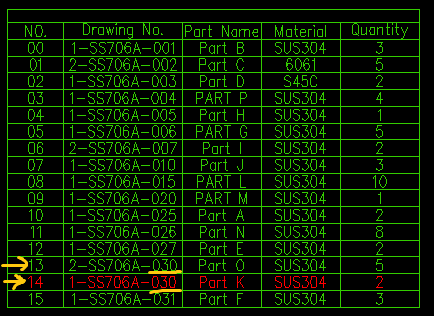

Tharwat Posted November 17, 2014 Posted November 17, 2014 HiMaster Tharwat. It doesn't clearer ? Re-read post number 36 and compare it with the attached image. Quote
andy_lee Posted November 17, 2014 Author Posted November 17, 2014 Re-read post number 36 and compare it with the attached image. Master Tharwat. I don't understand . I don't know how to explain. Quote
Tharwat Posted November 17, 2014 Posted November 17, 2014 [ATTACH=CONFIG]51622[/ATTACH] row 13 and row 14 have same Drawing NO. ,so row 14 need to be in red since . Maybe you wanted to say 13 and 14 instead of ONLY 14 since they have the same Drawing No. in the two rows ? Quote
