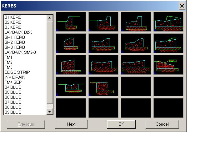

You can do it all with menu's and have a image appear automaticfly using slides or a slide library (group of slides) you can pick via either image or by name you do not have to write any code other than menu code which is really easy
***MENUGROUP=COGGSTDS
***POP1
**CADLIB
[LIBRARY]
[->Stddwgs]
[TRENCH]$I=COGGSTDS.TRENCH $I=*
[PIPES]$I=COGGSTDS.PIPES $I=*
[PITS]$I=COGGSTDS.PITS $I=*
[KERBS]$I=COGGSTDS.KERBS $I=*
[ROADX]$I=COGGSTDS.ROADX $I=*
***image
**TRENCH
[TRENCH]
[COGGSLD(CGG101,KERB]^C^C(openblk "S:/ACADSTDS/CIVIL STANDARDS/CGG101")
[COGGSLD(CGG102,NATURE)]^C^C(openblk "S:/ACADSTDS/CIVIL STANDARDS/CGG102")
**PIPES
[PIPES]
[COGGSLD(SD201,SUBSOIL)]^C^C(openblk "S:/ACADSTDS/CIVIL STANDARDS/CGG201")
[COGGSLD(SD202,FLUSHOUT)]^C^C(openblk "S:/ACADSTDS/CIVIL STANDARDS/CGG202")
