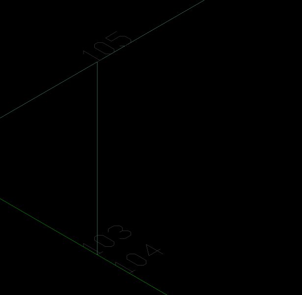

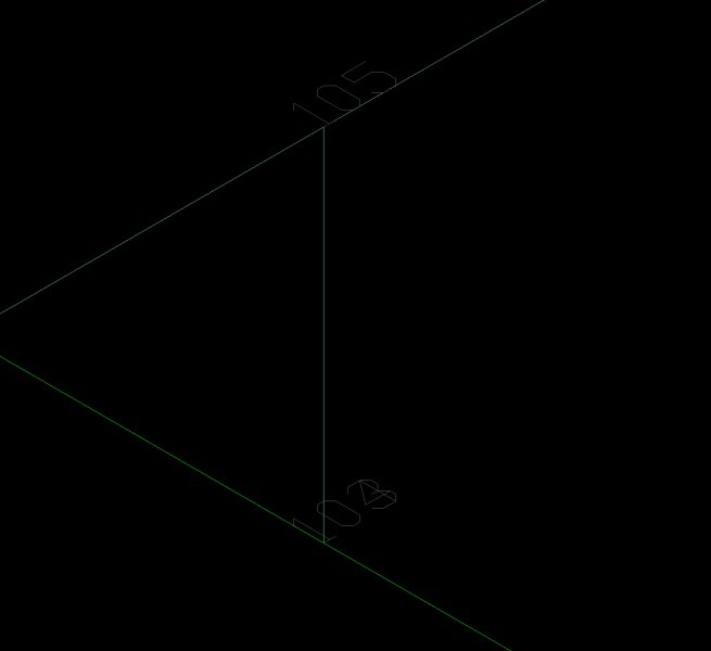

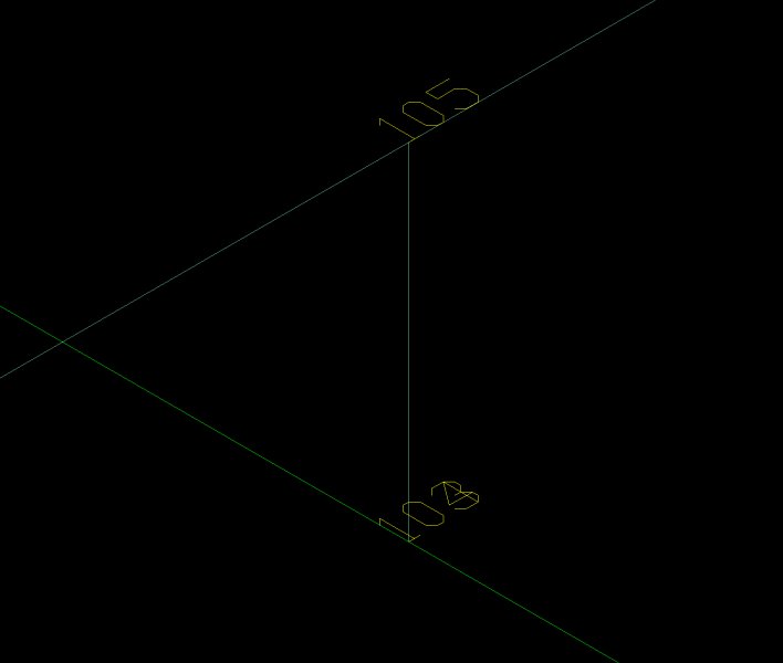

But very often I found out that two texts in one node were created. See images below. The lines are created just like I say on my first post.

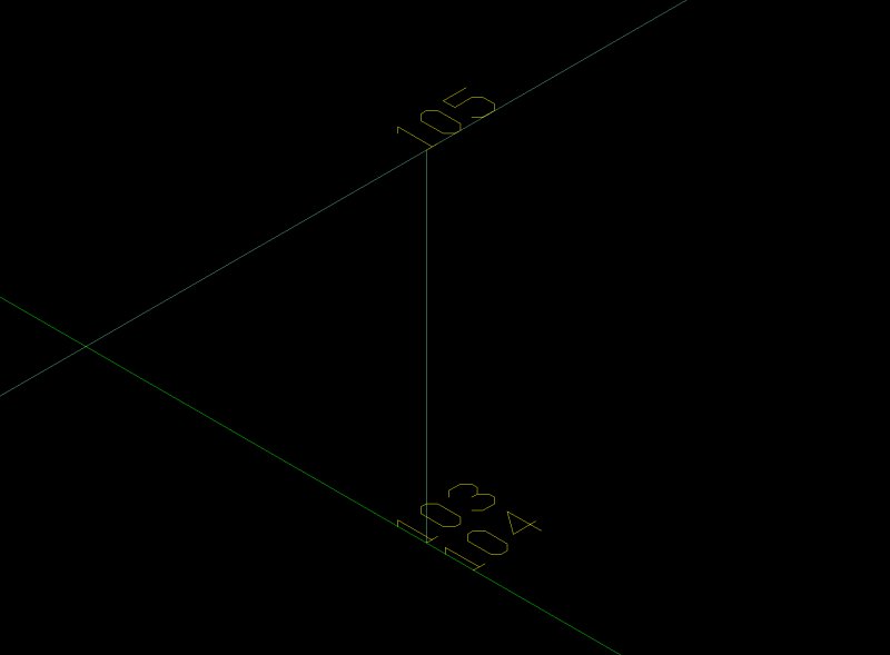

In this one below is the same as above, I only manually dragged the second text to make it clear.
Therefore I understand that there is some short of micro misalignment? However if I type, either 'id' command and click the endpoint of each line or (entget (car (entsel))) picking any line or text and looking at the assoc 10 coordinates (or 11), it will always give the same result, the coordinates of the intersection point. No difference. This has implications on the way as other codes I have written do not interpret the nodes correctly giving wrong results. Any ideas why is it doing that?
I tried the code you posted and found a couple of typos. E.g., (Command "layer" ... should by "-layer" and two instances of pl should be plnod. Since the labeling error only occurs occasionally it is very difficult to debug without an actual example and the code you are using. Can you supply the code and example that produces the problem? My first thought was that perhaps there is an extra line. But, if this were the case you would have two extra text labels not just one as you have pictured. If you do a left-to-right select window that includes the labels 103, 104, 105 and the vertical line what do you get for an object count? You should get 4.
I have given your accuracy concerns more thought and feel there may be a possibility that some noise could creep into the least significant digits of the coordinates you are retrieving and then examining with the member function. Another approach to try would be to do some rounding before building your list of coordinates. With 15 significant digits you should have some room for rounding.
First look at the largest coordinate that a node may have. Then determine what is the most precision you will need for a coordinate. I would add two orders of magnitude or more to compensate for rounding. So, if the extents of your model are +/- 1000 meters and you need a precision of 0.0001 you will need about 10 significant digits. I would try rounding node coordinates to 0.00001 before placing them in the list and doing the list search with the member function.
