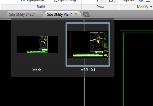

I don't have a solution for you but this bit of knowledge might be of some help.
Windows taskbar is limited compared to AutoCAD's drawing tabs. You get previews and can go directly to any layout in any open file. You can execute print or publish from them. There are also a number of tools available from the right click menu.
Edited by RobDraw
Version dependent response may not help OP.
