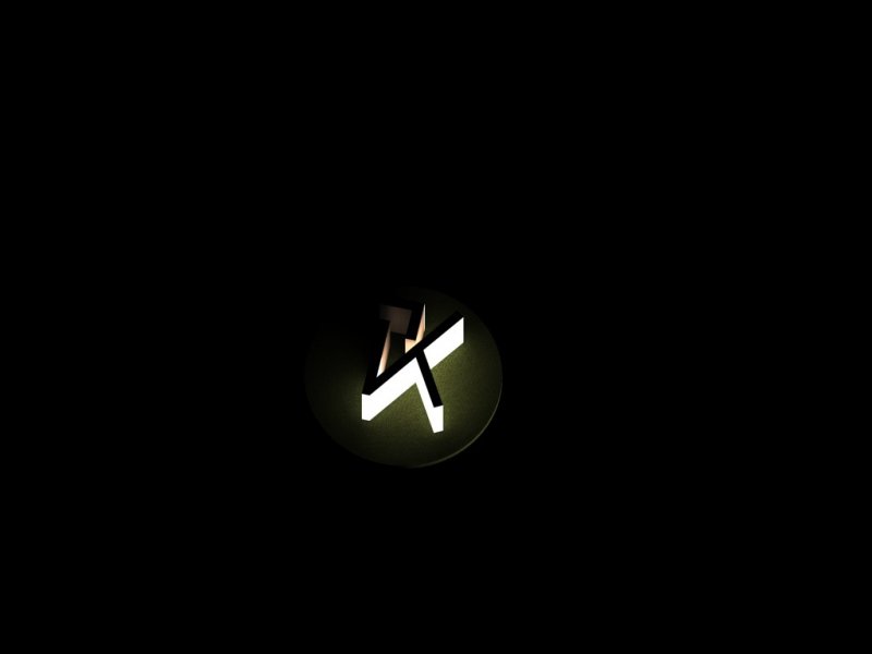

zionshea Posted January 1, 2015 Author Posted January 1, 2015 Thanks a lot Irm for your educating and detailed answers. I could not answer until now as I was very busy. I followed very carefully after your advice and also created a 3D with my logo as the size of my building. I also used same materials of the original building (wood and bricks) as you see in attached files, the rendering is very dark and has no sun or shades and the bricks wall very bright - I could not send the dwg as it is too big. Thanks for your help. Quote
lrm Posted January 2, 2015 Posted January 2, 2015 Have you turned on the Sun? The buttons in the ribbon should look like this: Your image implies a light very low in the sky (close to a rising or setting sun) and of high intensity. Check that if you are using sunlight that the time of day is close to Noon so that the sun is high in the sky. Make sure there are no other lights in the model when you start by opening up the Lights in Model dialog box via the noted arrow. It would help to have a copy of the file. Can you put it in Dropbox or some other cloud location I can access? Quote

tzframpton Posted January 3, 2015 Posted January 3, 2015 Don't forget to download and install the Dropbox program for best results!! https://www.dropbox.com/install Thanks a lot all for your support. I just created an account with Dropbox. This is the dwg file. https://www.dropbox.com/s/bap7tty46jmop8i/lighting.dwg?dl=0 Thanks, zionshea Here is my result: I have attached some screenshots outlining in red the settings I have adjusted: https://dl.dropboxusercontent.com/u/4989089/render_settings.zip I know you used Mass Elements but I rendered in plain AutoCAD just for a quick turnaround. One thing is I couldn't get Sky to light up your original file so I Copy/Pasted into a blank file. I just didn't want to take time to find the issue. In a nutshell, start with the Presentation render setting and adjust the few categories I outlined. Then turn Sky on and set it to Sky Background & Illumination for best results. Adjusting the shadow settings is key, which gives a gradual attenuation (falloff) of the shadow instead of the unrealistic hard shadow edge. Lighting Units will need to be set to 1 or 2 which enables photometric lighting, which you will be prompted to do so if you enable Sky. Hope this helps! -TZ Quote
zionshea Posted January 3, 2015 Author Posted January 3, 2015 Thanks a lot Irm and TZ, I manged to turn on the sky after I changed the view to perspective (PERSPECTIVE=1). Also set LIGHTINGUNITS=2. After changing the settings based on your comments I managed to see some good shadows and light and also looks like the materials are better than before. Regarding materials, I still need to see in my original 3 stories building. Somehow the sky shows as gray only... how can I add clouds? - as I remember, it is very simple with Revit. Quote

zionshea Posted January 4, 2015 Author Posted January 4, 2015 I really appreciate your time and willing to help. With your guide I managed finally to see my building in a wonderful sun light and correct shadows. For the benefit of those that will read this post I would like to point the three fixes that helped me to see the world in light...: 1. The reason for the complete darkness was because I used a timezone of Jerusalem and location of California in USA. I fixed the location to Cyprus and the light showed up. 2. Missing light in the sky was because the SKYSTATUS was set to 'Sky off'- I turned it to 'Sky background and illumination'. As said before this setting was possible only after I changed the view to perspective (PERSPECTIVE=1). 3. Main reason for too bright materials (the bricks were totally white) was the setting of the 'International Lighting Units' I changed it from 'Generic lighting Units' to 'International Lighting Units' (set LIGHTINGUNITS=2.) and materials looks better now. Thanks a lot for you prompt responses. I actually have some questions in the beginning of this post that remained without answers - i will check later again and ask them if still required. Quote
