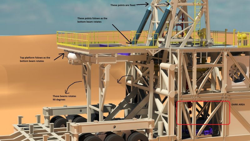

Hi,
See attached model i saved in 2012 version. Imported from Inventor.
I want to animate it exactly as shown in this video. Only difference is that mine is 3 stage.

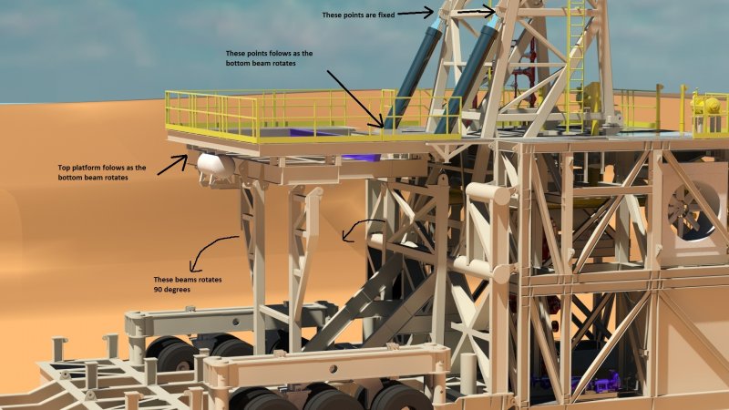

Also, see the attached picture showing what exactly i want the cylinders to do.
Sorry for the crap render.
One more quick question. On the lower right corner of the picture you can see the dark area under the shadow. How can i illuminate that area. I tried using different types of light but not able to do it.
I am using only one light in the model and that is Daylight system.
Thanks.

The jpeg of the rig shows twin hydraulic rams, double acting if they are raising and lowering that platform.
Just looking at the general geometry there then, yes they would have to be 3 or 4 stages.
When lowering the platform (extending the rams) as this is under power the sequence would be largest diameter tube out first, next largest second, etc.
When lifting the platform (retracting the rams) as they are pulling against platform the sequence will be the same, largest in first, next largest second, etc.
On a design note; the way you have the rams positioned means that you are using the cylinder retract to lift the platform.
If you could have positioned them underneath then you would be using the more powerful cylinder extend and could specify a smaller cylinder to do the same job. (Of course this would mean that the tubes would be extended all the time the platform was raised).
It's all to do with oil pressure and area, when the oil is pressurised it is the same throught and so the cylinder with the largest area moves first against an opposing force until it comes to the end of its travel, then the cylinder with the next largest area starts to move.

Assume the hydraulic cylinder is composed of three parts, the outer, inner and middle cylinder. The local Z axis for all three is the axis of the cylinder. The pivot points of the outer and inner cylinder are at or beyond the end of the cylinder. Note, your original model for the cylinders includes a clevis hole detail. This detail may not be necessary as it might never be seen in the final animation. I’ve left them out in my sample solution.
Position the inner and outer cylinder so that their z axes are coincident.
Select the outer cylinder and click Animation, Constraints, Look AT Constraints and then select the Inner Cylinder. In the Motion tab change the Select LookAt Axis to Z. This should align the axes of the two cylinders.
Snap a dummy object (from the Create tab click Helpers) to the pivot point of the outer cylinder.
Add a LookAt constraint to the inner cylinder that looks at the dummy object. Fix the LookAt axis to Z.
You should now be able to move the end of the inner cylinder and the outer cylinder will follow its location. The next step is to add the middle cylinder.
Align the middle cylinder axis to the outer cylinder axis by selecting the middle cylinder and clicking Tools, Align, Align… when the Align Selection dialog box appears check the Z-axis for Align Orientation. The Middle Cylinder should now be in line with the inner and outer cylinders.
The location of the inner cylinder pivot point will needs to be linked to a point on the platform that is pushed up by the hydraulic cylinder system. Add a dummy object at this point and then link it to the platform.
Now we need to link the inner cylinder to the dummy object you just added. To do this first select the Inner Cylinder and then go to the Animation tab, Constraints, Position Constraints and then pick the dummy object.
You should now be able to rotate the platform and have the Inner and outer cylinders follow accordingly. You will need to manually adjust the location of the Middle cylinder with respect to the other cylinders via key frames to behave the way you want (e.g., the middle cylinder fully extends before the inner cylinder starts to move).
