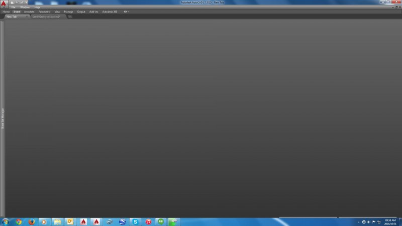

DonovanPorter Posted October 31, 2014 Posted October 31, 2014 Good morning all i'm not what caused this but i get a blank tab , when i select new tab... i've tried changing the variables but none return it to having all the tabs displayed Quote

DonovanPorter Posted November 3, 2014 Author Posted November 3, 2014 Good Morning Guys i have cycle though the options of NEWTABMODE -1,2,3. FILEDIA is currently set at 1 i have tried shutting down and restarting , no difference. i cant recall making any changes in the options dialog other than, crosshair, fade control and such. Quote

DonovanPorter Posted November 4, 2014 Author Posted November 4, 2014 i have had the programme for about 4 months of which i think it was almost a week that i had the new tab working correctly. i think it might have been a setting that is switched off, because of the curiosity of the new version. but then again i could be wrong. Quote
