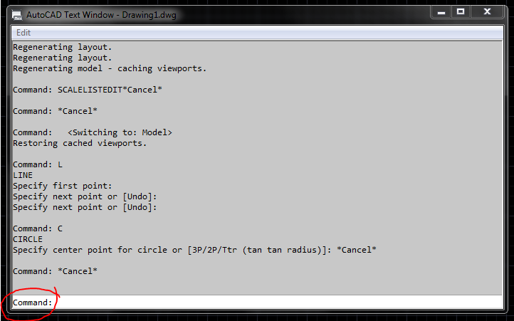

ReMark Posted October 27, 2014 Posted October 27, 2014 You don't have to as the command line appears at the bottom of the text window or haven't you noticed that? Quote

ReMark Posted October 27, 2014 Posted October 27, 2014 Location of Command line in text window. Quote
