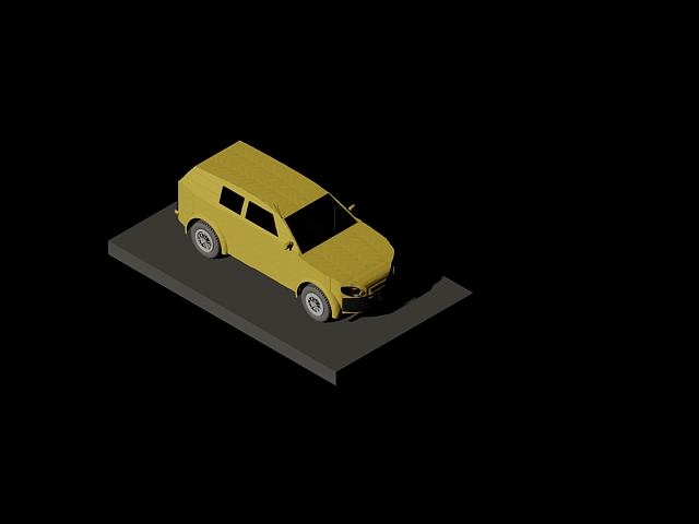

Davidak Posted October 31, 2014 Author Posted October 31, 2014 this is what I have been able to model(i know terrible!). No windows yet Quote
ReMark Posted October 31, 2014 Posted October 31, 2014 That seems a far cry from what you said you wanted to model back in post #20. What made you change your mind? Well, we all have to start somewhere right? Did you take a look at the last link JD Mather posted regarding a car modeling tutorial he wrote? Quote
Davidak Posted October 31, 2014 Author Posted October 31, 2014 Yes I saw the tutorial and I changed my mind about the car cos this seemed easier Quote
mikekmx Posted October 31, 2014 Posted October 31, 2014 this is what I have been able to model(i know terrible!). No windows yet[ATTACH=CONFIG]51446[/ATTACH] i'd say for a basic shape that is a very good start. some wheel arches added, fenders, lights etc will add to the look. maybe radius the edges a bit more. i think the wheels look great on it. Quote
Davidak Posted October 31, 2014 Author Posted October 31, 2014 I'm not satisfied with the way I got the shape i.e extruding top, side, front and back views, intersecting and converting to surface. I feel like there should me a more technical way using surfaces or mesh Quote
ReMark Posted October 31, 2014 Posted October 31, 2014 Then you should revisit JDM's link. Start with his tutorial. When done try something along similar lines (i.e. - not too complex). Quote

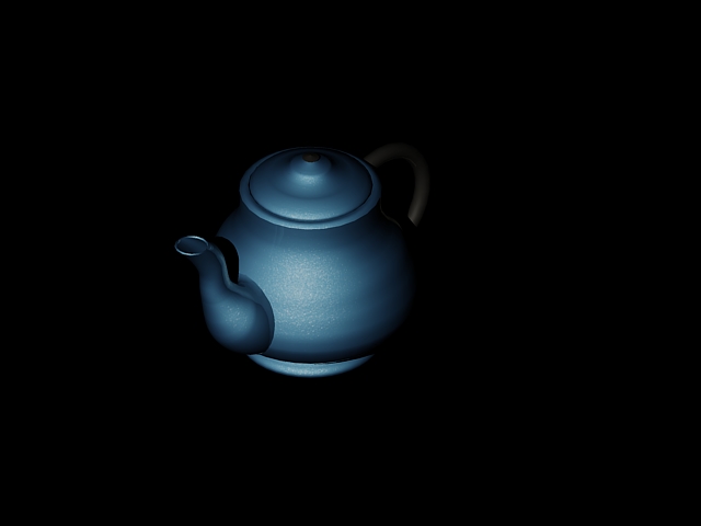

Davidak Posted November 1, 2014 Author Posted November 1, 2014 I recently worked on another teapot and this is the result Quote

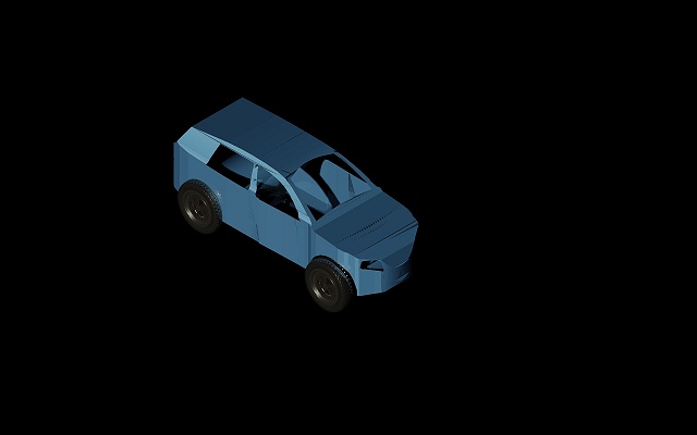

Davidak Posted November 6, 2014 Author Posted November 6, 2014 This is what I finally ended up with. I guess its not too bad. Thanks for all the help guys Quote
f700es Posted November 6, 2014 Posted November 6, 2014 Not bad, now work on presentation style. I would add a few more lights, change the view to perspective (not parallel). Work on materials a bit as well. A very good start Quote
