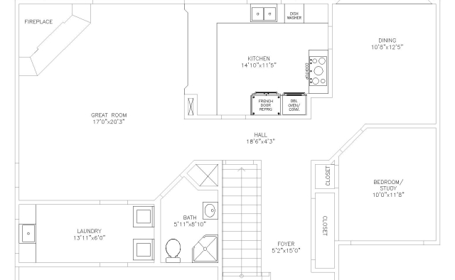

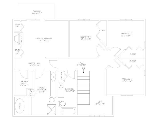

julimor Posted October 24, 2014 Share Posted October 24, 2014 I'm running MEP 2008. I have three floor plans in three different files. 2nd floor plans shows door swings when in plan view. 1st and basement levels do not. I've checked the properties on the 2nd floor plan and duplicated them in the other files. Nothing changed. I've tried everything I can but I can't seem to figure out why one plan shows the door swings and the other two do not. On the 2nd floor, the door swings show On the 1st (and bsmt.) they do not I can't find any differences between the files. I'm lost. Any help is appreciated. Thanks, Julie Quote Link to comment Share on other sites More sharing options...
Dana W Posted October 24, 2014 Share Posted October 24, 2014 There are no door blocks inserted on the other floors. There are only openings indicated where they should be. The jambs, the open door, and the swing arc are all part of the same block. Quote Link to comment Share on other sites More sharing options...
nestly Posted October 24, 2014 Share Posted October 24, 2014 Assuming the drawing is done with AutoCAD MEP/AutoCAD Architecture, it looks like the cut plane is above the door jamb. 6:00 to 7:30 here Quote Link to comment Share on other sites More sharing options...
Dana W Posted October 25, 2014 Share Posted October 25, 2014 Assuming the drawing is done with AutoCAD MEP/AutoCAD Architecture, it looks like the cut plane is above the door jamb. 6:00 to 7:30 here That perfectly explains why we can't see the doors. I was once again thinking in 2D. 'Course, that still don't mean the blocks are there. Side question; Would the door openings in the walls show with the cut plane over the height of the doors? Quote Link to comment Share on other sites More sharing options...
julimor Posted October 25, 2014 Author Share Posted October 25, 2014 I'm working with AutoCAD 2008 MEP. When I select the door and right click "Edit Door Style" on the 2nd floor plan, I see "Plan Screened" and "Threshold Plan Screened" in bold. All the rest of the options are not in bold. When I select a door in the other files (and I can only do so by going into 3D view on these files) and right click on "Edit Door Style", I see "Model Screened" in bold. This is also the same in the properties/display view. There is no option to change this in the properties view nor can I change this in the "Edit Door Style" view. Quote Link to comment Share on other sites More sharing options...

danellis Posted October 27, 2014 Share Posted October 27, 2014 Model Screened is *probably* a Display Representation or Representation Set (whoever thought up how all this works was definitely told not to worry about keeping it simple!). You should be able to copy "Plan Screened" into your basement drawing by: open both files, then switch to the basement file; On your Manage ribbon there should be a group of icons grouped as Style & Display in which there should be your Display Manager. This will list all of your open drawings. You should be able to find "Plan Screened" in your Second floor file and then copy it into your other files to access it. dJE Quote Link to comment Share on other sites More sharing options...
hertz hound Posted October 29, 2014 Share Posted October 29, 2014 I'm working with AutoCAD 2008 MEP. When I select the door and right click "Edit Door Style" on the 2nd floor plan, I see "Plan Screened" and "Threshold Plan Screened" in bold. All the rest of the options are not in bold. When I select a door in the other files (and I can only do so by going into 3D view on these files) and right click on "Edit Door Style", I see "Model Screened" in bold. This is also the same in the properties/display view. There is no option to change this in the properties view nor can I change this in the "Edit Door Style" view. What is in bold is the current display configuration. If you change the current display configuration at the bottom right while in the drawing editor, and go back into "edit style" the different display configuration will be in bold. Did changing the cut plane fix your problem? It looks like that would have done it, unless part of the door component was shut off in the "edit style" for the display configuration. Quote Link to comment Share on other sites More sharing options...
