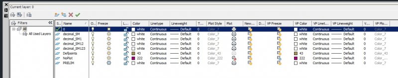

Dinochrome Posted October 24, 2014 Share Posted October 24, 2014 I have a layer that seems to displaying incorrectly. I am trying to freeze "NoPlot" through a viewport. It is also freezing out on paperspace. Am I wrong in thinking it should only freeze "inside" the viewport? Test.dwg Quote Link to comment Share on other sites More sharing options...

nestly Posted October 24, 2014 Share Posted October 24, 2014 Yes, VPFREEZE in Modelspace viewports is independent of VPFREEZE for the Paperspace Layout. In your drawing, the layer is frozen in both the VP and PS. With Paperspace active, clear the VPFREEZE override for the layer. Quote Link to comment Share on other sites More sharing options...
Dinochrome Posted October 24, 2014 Author Share Posted October 24, 2014 Here is a screen shot of my layer properties manager - as I see it: Quote Link to comment Share on other sites More sharing options...
Dinochrome Posted October 24, 2014 Author Share Posted October 24, 2014 Tab 03, I am in paperspace, "NoPlot" is not frozen in model, it is frozen in "through the viewport". It should look like tab 2 showing a color 222 viewport, but with two circles in the lower right, around the working area? Quote Link to comment Share on other sites More sharing options...
Dinochrome Posted October 24, 2014 Author Share Posted October 24, 2014 There's something messed up with the file. Not a big deal. I can work around it. I just thought it was interesting. Quote Link to comment Share on other sites More sharing options...
nestly Posted October 25, 2014 Share Posted October 25, 2014 Perhaps I mis-understand, but I seem to be getting exactly the opposite result. When Paperspace is active, VPFREEZE does not VPfreeze the layer, nor does it VPfreeze the viewport(s), rather it freezes the whole layer. When a viewport is active, VPFREEZE does what's expected and only VPFREEZEs the layer within the active Viewport. Either way it still seems like a bug/quirk because it seems like VPFREEZE command in PS should do the same thing as toggling the VP Freeze button using the Layer Manager. Quote Link to comment Share on other sites More sharing options...
