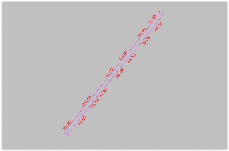

I need some LISP routine which autonumbers distance between polygon vertices.

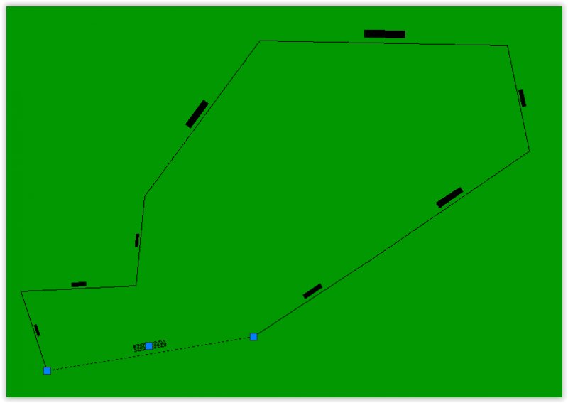

I will use for that the built-in QDIM command with an appropriate dimension style (that it, hide the arrows, extension and dimension lines); don't forget to set an adequate UCS first. After call QSELECT with a filter for dimensions with Measuring feature smaller than given value and remove them. This will also ensure that the result is associative.
For some weird reason QDIM seems not to work on AutoCad Map. It's a pity that the suggestion posted above doesn't solve the problem. This LISP routine would greatly help since it takes ages to place those distances between every vertex.

The final result should look like this:
The code posted above gives this result:
Could anyone edit that routine so the final result looks like the one I need?
hi Basomis,
try remove this line
(vlax-put-property obj 'TextFill :vlax-true)
Awesome, it removed textfill. But I also want to remove the dimension line below the number. The numbers should round to 2 decimal places and every number should appear outside the polygon. Is it possible to implement these requirements?

Great, the line below numbers don't appear anymore. The only thing left is how to make all numbers appear outside of the polygon?
Among my lisps like autoaldim.lsp, I've found somewhere on www, pdim.lsp that has this option (Inside/Outside)... Now you'll have to combine what's already explained and this pdim.lsp...

Updated as OP request, put text outside polygon
added 2 arguments
cw : T / nil ; cw/ccw
box : T / nil ; if T, Label with box
;ppdim.lsp , assosiative distance label (customized dimAligned)
http://www.cadtutor.net/forum/showthread.php?89363-Automatic-distance-between-polygon-vertices&p=612627#post612627
(defun ppdim ( p1 p2 [color="red"]cw box[/color] / mp sz mx ); [color="red"]v1.1[/color]
