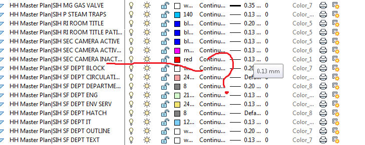

I have a drawing with an XREF linked into it, which in turn, also has several XREFs linked into it. On the primary XREF drawing I have created several layers, placed several objects on them, and everything is displaying just fine in the drawing once I XREF it in. The problem that has arisen has been that all the layers that I created previously appear just fine in the list of layers, but the newly created ones don't. The objects that are on the layers are displaying just fine in Modelspace, but the layers aren't present. When I've tried freezing all the layers (go to the layer dialog menu, select all the layers and freeze them), the objects remain on the screen. I really need for these to appear in the layer list so I can manipulate them later, so any help you guys can provide would be immensely helpful.

Drawing A is the one I'm working on
Drawing B is the one I've created objects on and is being XREF into Drawing A
Drawings C D & E are drawings that have been XREF into drawing B (nothing wrong with them, just including them for completeness)

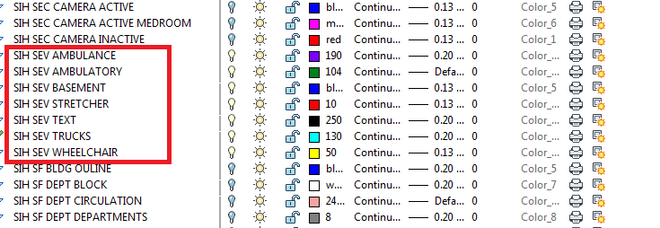

I've created the layers on drawing B, and when I XREF it into Drawing A, the objects I created appear just fine in modelspace, but the layers don't appear in any of the lists. I've included screen shots in case that might help. And I don't have any filters on as far as I know.

Check the variable MAXSORT, set it up to the max "32767" and see if they display.
I wonder how that number was arrived at as the maximum value. If the total number of layers exceeds that setting, they will not be displayed in the chosen sorted order.
That did it. It was set to 1000 originally, and they're all showing up now. Thanks!
