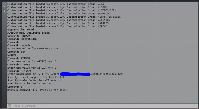

fd9db62e Posted October 20, 2014 Author Posted October 20, 2014 Thank you for the replies. I am still having issues though. steven-g said: That nearly works, I just needed to add in the Y scale factor (and no quotes around the insertion point) and it needs to be done as a list type of script (seperate lines). For the first part keeping it on one line is ok, but when you get to the attribute values, they have to be on separate lines, a script will accept a space as part of an input string so it just joins all the remaing parts of a line together, and then it hangs waiting for the second value. So for just one inserted block with 3 attributes it should read as follows.attdia=0 -insert block1 20,20 1 1 0 A G H And attdia=0 This did help with the format I was using etc. I still cannot make it work though. To see if it was an issue with the blocks I was using I have created a Test Block (TestBlock.dwg). The attached picture is the properties for the attribute. Maybe I am doing something wrong when I create the block and attributes? Here is the base code I am trying: ATTREQ 1 ATTDIA 0 -insert "*C:\Users\DEFAULT\Desktop\TestBlock.dwg" 0,0 1 0 NEWVALUE I have tried it with/without ATTREQ. I have tried just putting a value in (NEWVALUE) I have tried putting the Tag first (VALUE) (NEWVALUE) I have tried putting the prompt first (VAL) (NEWVALUE) I have tried putting in the old value (TAG) (NEWVALUE) I also tried using A and Attribute prior to (NEWVALUE) trying to see if I needed to trigger it somehow... No matter what I do I end up with the block being inserted and a "Unknown Command:" for the last line. Thoughts? YZ said: Last week I learned that if the block is set to scale uniformly (y and z scales are linked to the x scale), then it won't ask for the y scale upon insertion. It is unlikely the OP will need to know that, but we use a mix of both, so it was a spanner in my works until recently. At least for the test block I created this ended up being quite useful. (see above example code) Quote
YZ Posted October 20, 2014 Posted October 20, 2014 (edited) This is probably not the issue, but I think the syntax for scripting system variables ought to be ATTREQ 1 ATTDIA 0 Have you tried inserting this block manually using the -insert command at the command line? Does that give you any clues? What does you command line say when you run this script? An especially, what is the last thing is says after it breaks? Edited October 21, 2014 by YZ Quote
fd9db62e Posted October 20, 2014 Author Posted October 20, 2014 YZ said: This is probably not the issue, but I think the syntax for scripting system variables ought to be ATTREQ 1 ATTDIA 0 Have you tried inserting this block manually using the -insert command at the command line? Does that give you any clues? What does you command line say when you run this script? An especially, what is the last thing is says after it breaks? The syntax I have seems to work for the ATTREQ and ATTDIA. The command line looks pretty much the same if I type each line manually. It doesn't "ask" for the attribute it just "ends" the command after putting in the rotation. Quote
YZ Posted October 21, 2014 Posted October 21, 2014 Quote The command line looks pretty much the same if I type each line manually. It doesn't "ask" for the attribute it just "ends" the command after putting in the rotation. If that is the case then it probably has to do with your block definition. If you upload the testblock.dwg I'm happy to have a look. Or you can check for yourself, when you insert it it should prompt you for the attribute value. Try inserting it in a new drawing that does not already have that block defined. When creating blocks with attributes it is important to create the attributes before writing it to a block. Quote

steven-g Posted October 21, 2014 Posted October 21, 2014 The problem is that stray "1" that is being given to the command line after the rotation value, that message "unknown command" is the giveaway, the first thing I would check is to make make sure you don't have any spaces at the end of any lines in your script. Could you post a copy of the block and your script file (you will have to change the extension from .scr to .txt or it won't be accepted Quote
MSasu Posted October 21, 2014 Posted October 21, 2014 Fd9db62e, since your script revert to command prompt after setting the angle and ATTREQ is set to 1, I would say that your block doesn't have any attributes. Can you upload it here? Quote

MSasu Posted October 23, 2014 Posted October 23, 2014 There were a few issues with the drawing and the script: The block is defined in the attached drawing, so when attempt to insert it will appears to redefine itself. Please extract it using WBLOCK command. Missed to input the Y scale. By placing the "*" character at the begining of block name (path) will insert it exploded, therefore attribute's value will no be requested. The value for the attribute contains spaces, so must be enclosed in quotes. You have set your attribute to Verify, so need an additional for input confirmation. You may disable this parameter since may be useful only when set the attributes manually on prompter. There should be another line at bottom to allows the command to end. ATTREQ 1 ATTDIA 0 -insert "[color=red]*[/color]C:\Users\DEFAULT\Desktop\TestBlock.dwg" 0,0 1 [color=red]1[/color] 0 [color=red]"[/color](place holder)[color=red]"[/color] [color=red];end of script[/color] Quote
fd9db62e Posted October 23, 2014 Author Posted October 23, 2014 MSasu said: There were a few issues with the drawing and the script: The block is defined in the attached drawing, so when attempt to insert it will appears to redefine itself. Please extract it using WBLOCK command. Missed to input the Y scale. By placing the "*" character at the begining of block name (path) will insert it exploded, therefore attribute's value will no be requested. The value for the attribute contains spaces, so must be enclosed in quotes. You have set your attribute to Verify, so need an additional for input confirmation. You may disable this parameter since may be useful only when set the attributes manually on prompter. There should be another line at bottom to allows the command to end. ATTREQ 1 ATTDIA 0 -insert "[color=red]*[/color]C:\Users\DEFAULT\Desktop\TestBlock.dwg" 0,0 1 [color=red]1[/color] 0 [color=red]"[/color](place holder)[color=red]"[/color] [color=red];end of script[/color] Thank you! The WBLOCK was the main part I was missing. Prior to using the WBLOCK command it didn't ask for the y scale - post WBLOCK it does. The "*" character explanation makes sense and after using the WBLOCK command it inserts properly without it. I agree that turning verify off makes sense for insertion via cli. Thank you all for your input! I appreciate the help. Quote

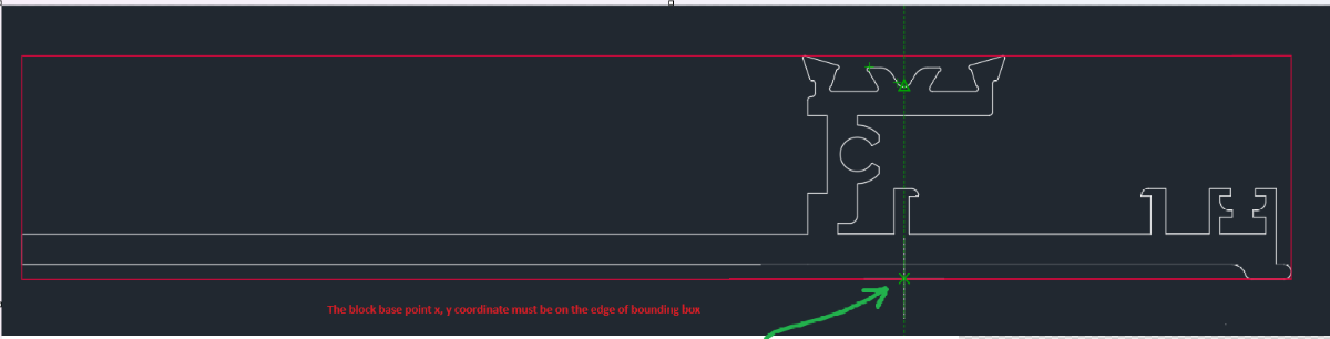

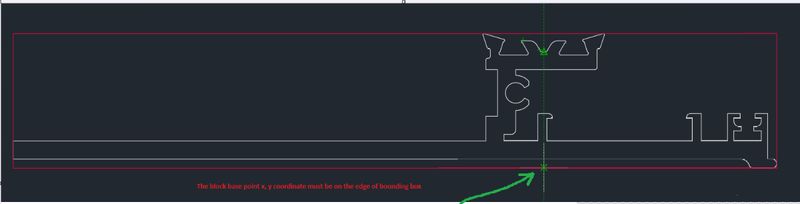

Wan Posted December 8, 2023 Posted December 8, 2023 (edited) On 12/7/2023 at 12:09 AM, BIGAL said: Explain what your trying to do. Expand Thank you for responding Big Al. Please help me to write script. I need it to place blocks base point at specific x, y coordinates for thousands of blocks and then move them to 0,0. Edited December 8, 2023 by Wan Quote
BIGAL Posted December 8, 2023 Posted December 8, 2023 (edited) "I need it to place blocks base point at specific x, y coordinates" yes understand, the block name and points say as a csv file or an Excel, Bname,x,y. So if doing manually you would use Bedit and move the block objects, based on a point in the objects now becoming 0,0. Need a dwg with at least 3 blocks and details of point X,Y to now become 0,0 by moving block. Edited December 8, 2023 by BIGAL Quote
