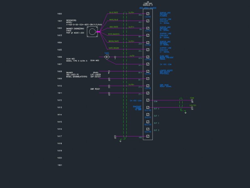

Working on project that I layout PLC panel I/O modules and wiring diagrams.
I use the insert PLC modules command and have inserted most of the modules but 1769-ASCII card I can't find in the Parametric list.
has anyone created a 1769-ASCII block.

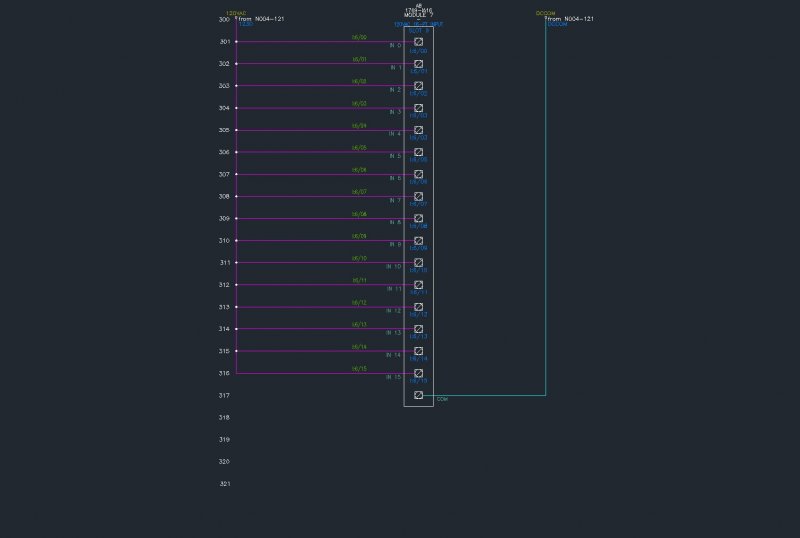

Hear is a sample typical I/O card12025-1324-SD-N013.jpg
2015 doesn't have it in the library. It would be quicker for you to make it than wait for a response here...
I would recommend u make it in the MDB file rather than the parametric PLC editing tool it would be much quicke.
