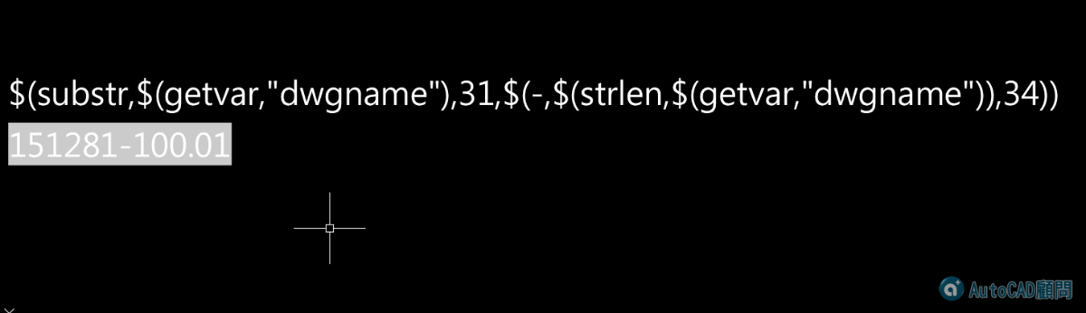

Voaraghamanthar Posted December 2, 2015 Share Posted December 2, 2015 I believe this is the correct one for removing .dwg from filename. Double check, because I use a few different ones for removing different portions. $(substr,$(getvar,"dwgname"),1,$(-,$(strlen,$(getvar,"dwgname")),4)) Can I ask a question? With that formula you provided, how can I extract only 151281-100.01 out a file name like this - Drawings-AFC-Electrical-D-CS1-151281-100.01.dwg Quote Link to comment Share on other sites More sharing options...
op90o Posted December 10, 2021 Share Posted December 10, 2021 (edited) 在 2015/12/3 在 AM4 點 47 分,Voaraghamanthar 說: 我能問問題嗎? 使用您提供的公式,我如何僅提取 151281-100.01 這樣的文件名 - 輸出-AFC-電氣-D-CS1-151281-100.01.dwg $(substr,$(getvar,"dwgname"),31,$(-,$(strlen,$(getvar,"dwgname")),34)) Edited December 10, 2021 by op90o Quote Link to comment Share on other sites More sharing options...
