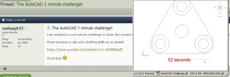

I still haven't watched the end of the video. I did it without dims in 52 seconds on the first try while typing out the commands to prove I wasn't cheating or using preset values for the commands, but I probably spent 2 minutes thinking about it before I started, so I'm not sure which is my official time. (I'll post the videocap later so as not to spoil the results.)

Actually, I did capture it, I just thought it better not to post just yet.
I'll PM you the command history if you're interested. ;)

I started with a three sided polygon.
Sweet, I started with a 3 segment closed polyline.

Failed with 1:12 using 4 circles, copy twice (quadrant/intersection), circle 3p grip edit for center, 3 lines from center offset and then delete, finish of with trim.
I am more intrigued by this as an exercise in logic, than a race against the clock.
What is the least number of commands with which anybody can do this?
I too, like eldon used a 3 sided polygon Circumscribed about a 45 radius circle.
Used a Scale command with Reference to upsize to the 300 long sided equilateral triangle,
offset by 70 and filleted (Polygon modifier) with radius 70 (no tangentcy issues).
All the circles are simple enough, as you still have the defining equilateral triangle intact.

I used 6 different commands, but 2 were repeated in succession so, 8 commands total
If you preset the Polar to 30, why not preset your Fillet radius to 70, and the offset to 70??
I managed with only using Endpoint Osnap.
30 degree polar and running End & Mid OSnaps are among the drafting aids that I always have running, they're not specific to this exercise. Similarly, I entered each value for the commands during the exercise because that's how I'd typically do it anytime else as well. Yeah, I could have done it a few seconds faster, but that's the same procedure I used the first time I attempted.

Because I am slower than everybody, I cheat with my custom lisps (attached). Here is my try with my cheating:
polygon 3, e, 300
circle 3p > 3 polygon points
dc lisp 90 circle (diameter change lisp)
ccc lisp center, 35, 60, enter (lisp drawing multiple circles with common center)
mcopy 2 circles to all polygon points
jm lisp out 70, enter (jump lisp - offset + erase original object)
fillet r, 70, p, polygon
After first run polygon was preset to 3 sides, dc lisp to 90 and jm lisp to 70. Best time after 4 tries - 45 secs.
dc-ccc-jm.lsp
That's pretty awesome Paul. ENDpoint is the only Osnap you needed... right? Do you have it running, or do you activate it when needed?
I have endpoint, intersection, center and node constantly running whenever I draw (osmode = 45).
And, yes, endpoint osnap is all you need for this one.
Paul, the best time I could manage with my method (even using the stored value for Circle, Offset, and Fillet) was 46 seconds, however I got a best time of 39 seconds using your routine and your lisps when the value were already stored. Not sure how much I'll use the others, but I really like CCC :notworthy:
