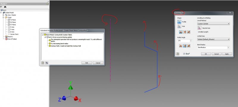

Contour Roll Command creatiion failed.?? What?? why?? Inventor 2014
I tried to use the contour roll but i got this error message on the pic below, can any one tell me how to decrease bend radius? where can i find the option? screenshot would be great. thanks
Error said:
"Sheet Metal: ContourRoll Creation failed.
Part1: Errors occurred during update
The attempted operation did not produce a meaningful result. Try with different inputs.
Try decreasing bend radius
Contour Roll1: Could not build this Contour Roll"

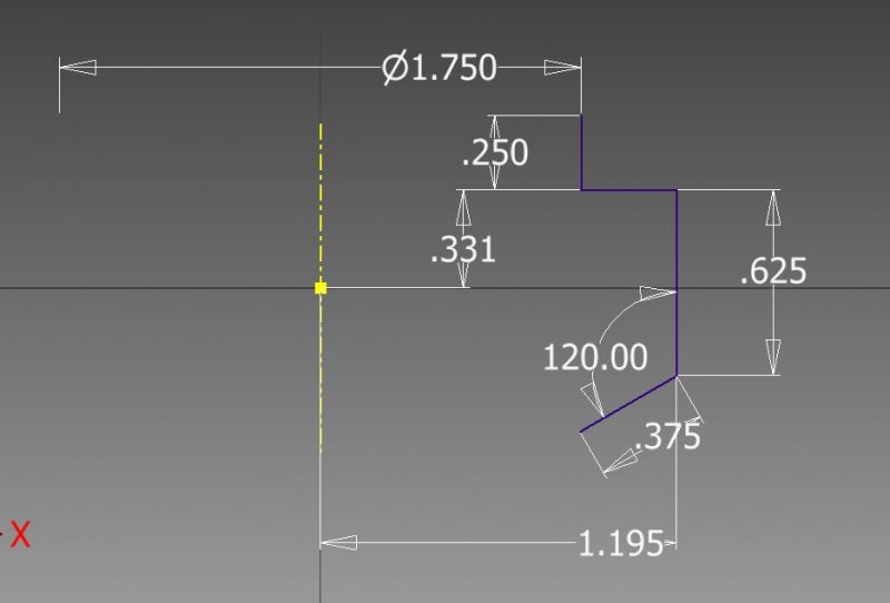

Before I answer the question -
I do not see ANY dimensions on your sketch?
I actually turned off the dim visibility since i know how. sometime they're very annoy.
Edited by Sengna
.......why do you suppose I would ask about your dimensions?
Turn them back on.
Turn them back on.
Please tell me what happend.
I will continue on this fishing expedition for information that could have all been revealed by simply attaching the file here.
In any case - it might help you reach logical deduction of why it isn't working.
Hint: What is your sheet Thickness set to?
Hint #2: What is 2*Thickness+Thickness?
Hint#3: What is Bendradius?

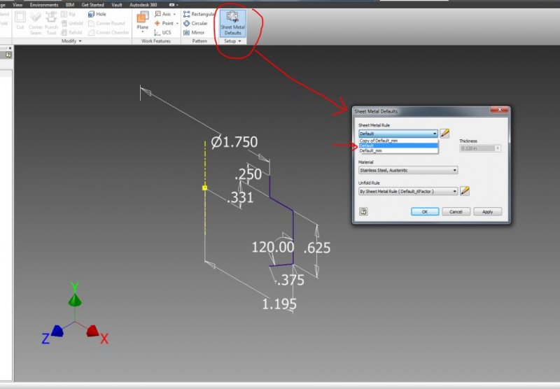

Weird, on the sheet metal rule, i want to set to like 10GA SS 25MM* but i don't have to drop down list for me to choose one on the default, how can i import in? The thickness is set to .500mm, where can i find the bend radius?

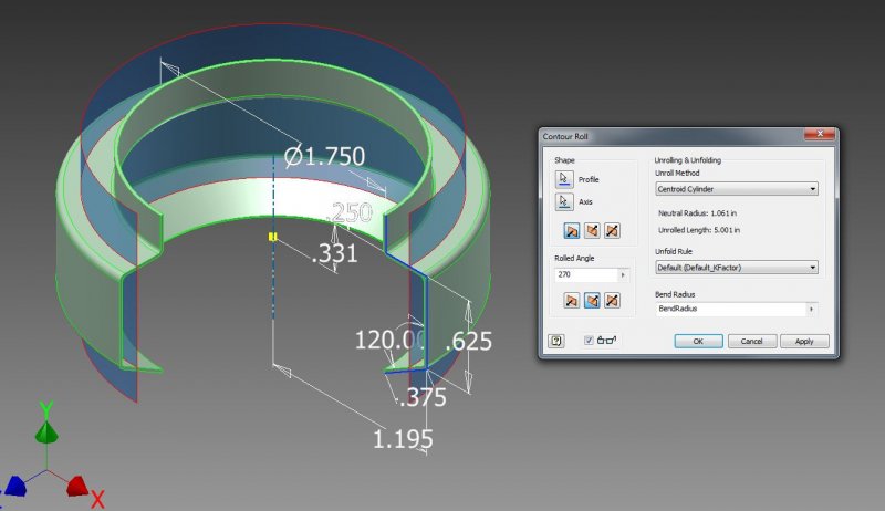

Interesting, on the sheet metal rule dialog, when i changed to Default_mm and it works. the question i have is that where can i select the 10GA SS 25MM*???
Default Bend Radius value is the same as sheet metal Thickness.
The problem in your original post is the bends were therefore too big for this small part - they would have intersected with no logical solution in the real world.
Lesson: Dimensions are important. I rarely hide them and only when I have a lot of sketches - never on something this simple.
