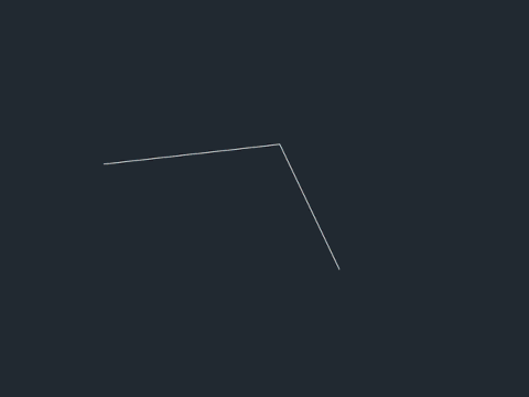

I'm trying to help someone using AutoCAD LT 2015 troubleshoot why they can't use Grips to stretch polylines along their Extension. (I don't have LT to test)
Can someone with LT 2015 verify whether Osnap tracking works as shown in the animation below when the Extension OSnap is running?

Sorted ... Automatic Alignment Point Acquisition had been inadvertently disabled in Options.
