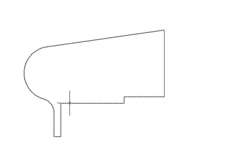

Bill Tillman Posted December 12, 2008 Posted December 12, 2008 Can someone please tell me why ACAD cannot extrude this shape. I did my best to be sure all the lines and curves were trimmed properly. But when I try to extrude it, ACAD says: Cannot sweep or extrude a self-intersecting curve OverlapErr.dwg Quote

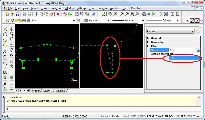

Raggi_Thor Posted December 12, 2008 Posted December 12, 2008 You had an overlap in the first or last segment. See what happens when you close the pline: Quote

shift1313 Posted December 12, 2008 Posted December 12, 2008 im not finding any extra lines in the drawing you posted i went ahead and played with it for a min. i exploded your drawing and added a line at the midpoint. deleted the upper arc and extended your top line to my vertical line intersection. deleted the right half of your drawing and used pedit>join on the left half(excluding the vertical line. To get my screen shot below. then i mirror this, pedit>join and it extruded fine. There was an issue with the bottom right part but i cant tell you for sure where it came from. if i am going to draw something like this and mirror it I will draw the left half of it and use pedit>join then use close. if there are no issues at that point, there should be no issue later on. Quote
Raggi_Thor Posted December 12, 2008 Posted December 12, 2008 ....I have been noticing that my ACAD 2009 progam is a hit or miss when doing pedits. Even with a simple four sided shape. Sometimes it closes on the first try, other times it won't. . If you do a PE (pedit) and Join, I think you'll see the option Close aferwords if it's not closed. If the option is Open, then it's allready closed. Quote
totzky Posted December 14, 2008 Posted December 14, 2008 You were unable to extrude your polyline because there are lines on top of each other. To prove my point, Explode your polyline object and erase your line one by one.I mean, Plick and erase to see for yourself. To save yourself of trouble like this the next time around, do an OVERKILL first before joining your entities. Quote
