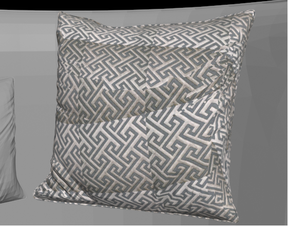

I am using 3ds 2015 on a Dell running Windows 8.1 (6GB RAM, 1.9 GHz). I am extremely new to 3ds (like just downloaded four days ago). I have a problem with an object becoming distorted after applying textures to it. The object is from an older 3ds file I downloaded.

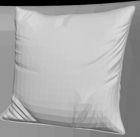

Before texturing the object looks like this:
Smooth surface, great pillow form. After I apply a texture, it turns into this:
Lines appear, the tiling is off, and there is a section that is discolored as well as distorted. I'm guessing the problem is something inherent to the object. I've searched for a solution and tried to use the smooth modifier after converting to polygon, but that hasn't had any affect. Anyone have any ideas? Im hoping for a point and click solution, but am willing to dig in with good directions.

It looks like your pillow does not have UVW coordinates, or your texture is not tileable. Unfortunately, this is not just a point and click situation.
This is a rather old tutorial, but it will at least give you the basics about what a UVW map is and why you need it: http://waylon-art.com/uvw_tutorial/uvwtut_01.html
Tileable textures are important so you don't get those seams you're seeing on the pillow. There are lots of tutorials online that discuss how to create seamless and tileable textures: https://www.google.com/?gws_rd=ssl#q=tileable+textures+tutorial

It was the UVW mapping! I followed the directions on that tutorial using my pillows, and they came out wonderful!
They're still a little blocky around the bottoms, but they won't be upclose in the scene so you can't really tell.
