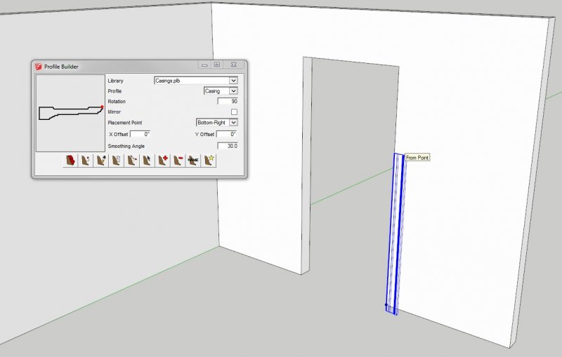

Dana W Posted October 8, 2014 Share Posted October 8, 2014 Well that's not to say that SU Make (free) can't be a good tool, it can. One just has to know what they want to do with it. I for one love SU and I have seen some greats models come from it. I hope that does help you Sid. The power of SU is similar to what made Acad popular, the ability for users to write scripts and customization. Click on the link at the bottom of my post Sid to see some of the things I have done with SU. Sean I have discovered that it cannot even extrude, say a molding profile with the push/pull tool like a typical oh-gee shape because of the arcs. That also is probably because I don't know how to do it right. It will push/pull faces made of straight lines all day though. I'll be looking at some better software to use, myself. I might have the need to do 3D conceptuals of furniture in a bit, and I will need curvy stuff for that, betcha. Quote Link to comment Share on other sites More sharing options...
f700es Posted October 8, 2014 Share Posted October 8, 2014 It can extrude profiles I'll even share a moulding/profile add-on with you. +1 on Wings3D Quote Link to comment Share on other sites More sharing options...
Dana W Posted October 8, 2014 Share Posted October 8, 2014 It can extrude profiles I'll even share a moulding/profile add-on with you. +1 on Wings3D It must be operator error then. I have a CAD catalog of nearly 800 profiles, and it just dawned on me that I can probably bring them into SKUP and pull my hair out trying to learn to use them on a 3D wall full of raised panel wainscot & chair rail or something. That is IF I can figure out how to get them up off the danged floor, where SKUP drops them, as a block apparently. What I really got flustered at was trying to draw a mitered joint at two pieces of molding, but that was some time ago. My SKUP skills are nearly non-existant, and now that I really want to get into the rudementary end of 3D, I have so much 2D millwork to draw, I don't have time or energy to do it right now. When it rains, it pours. I may have time to invest in a significantly lengthly SKUP thought process in a couple of weeks. Quote Link to comment Share on other sites More sharing options...

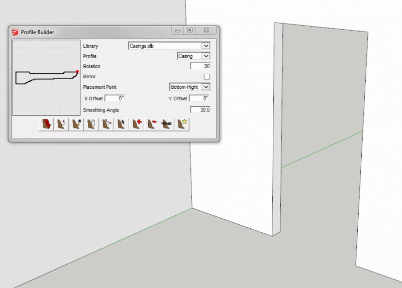

f700es Posted October 9, 2014 Share Posted October 9, 2014 OK trying to upload a gif image but for some reason it changes the file type to jpg instead of gif. Oh well I had a nice animation of the tool in action. Profile Builder (free) http://www.smustard.com/script/ProfileBuilderFree I have the free one but there is one for $20 that allows custom patterns I believe. Dana, you have to remember that SU lines are "sticky" and react with other lines and faces. Using groups will get around this and allows you to extrude curved profiles better. Also look at the "Follow Me" in SU for extruding along a path. Quote Link to comment Share on other sites More sharing options...
Dana W Posted October 9, 2014 Share Posted October 9, 2014 OK trying to upload a gif image but for some reason it changes the file type to jpg instead of gif. Oh well I had a nice animation of the tool in action. Profile Builder (free) http://www.smustard.com/script/ProfileBuilderFree [ATTACH=CONFIG]51217[/ATTACH] I have the free one but there is one for $20 that allows custom patterns I believe. Dana, you have to remember that SU lines are "sticky" and react with other lines and faces. Using groups will get around this and allows you to extrude curved profiles better. Also look at the "Follow Me" in SU for extruding along a path. I'll have to look at that one. Seems pretty helpful. 20 bucks, huh. Not bad. Truth be known, I don't have a large outlet for custom profiles at the moment. People choke on the cost of getting the shaper knives made. When I used them, I was working for a guy who only did custom profiles. His stuff is in houses of more than one Reagan administration cabinet member. I'll be good to go with the typical vendor catalogs for the time being, that I currently use from time to time. Follow me has had me entrapped for several hours, since yesterday. getting the path right is the trickiest part. I spent a while just trying to see what it can do. I accidentally built a couple of alien spacecraft. Quote Link to comment Share on other sites More sharing options...
