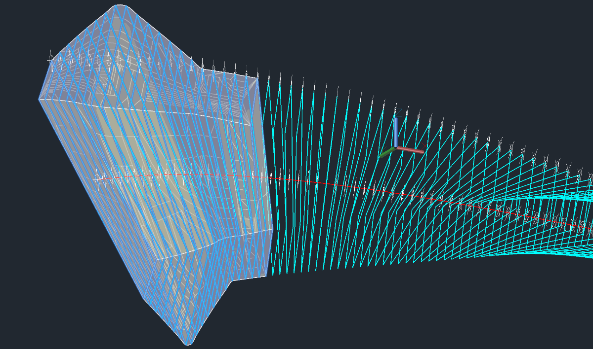

Ok, finaly I think that I got the best out of CAD for drawing the ramp of the "same" thickness (perpendicular to the surface)...
I draw the upper surface first using Irms cookbook, both center spline for control and left and right spline, offset by 1...
Than I used THICKEN to add the thickness to the surface... The reason I offset the splines by 1 is that THICKNESS command will not produce lower surface bordering splines following the cylinder... Than I did interfere with the cylinder subtraction shape (see the dwg) to produce side surfaces corresponding to the cylinder.
Drawing6.dwgFetching info...
The produced shape has the same thickens perpendicular to upper and lower surface (1), the upper side of slicing shape (slicing trough center of the cylinder perpendicular to the ground) are parallel to the ground, the lower are not, the resulting shape is trapezoid with parallel shorter sides...
I think it is as close as it gets... or?

@ibach  I'm glad that you have someting you like.  I've been working on a couple of LISP programs to enable the positioning of blocks along a spline.  The blocks are used to define the sections of a LOFT.  I had a coding question so I posted it on the AutoLISP forum.  Check it out at:
https://forums.autodesk.com/t5/visual-lisp-autolisp-and-general/blocks-along-spline-how-do-you-use-already-selected-block/td-p/13091335
Pleas try these programs and let me know what you think.  There is a minor issue with the code as noted.
Once you have the blocks positioned and rotated as you like then explode them and use loft.  Note that you can manually tweak the rotation of blocks by using UCS OB (object) followed by using the 2d command rotate.  It will allow you to dynmaically see the rotation of the block (section).

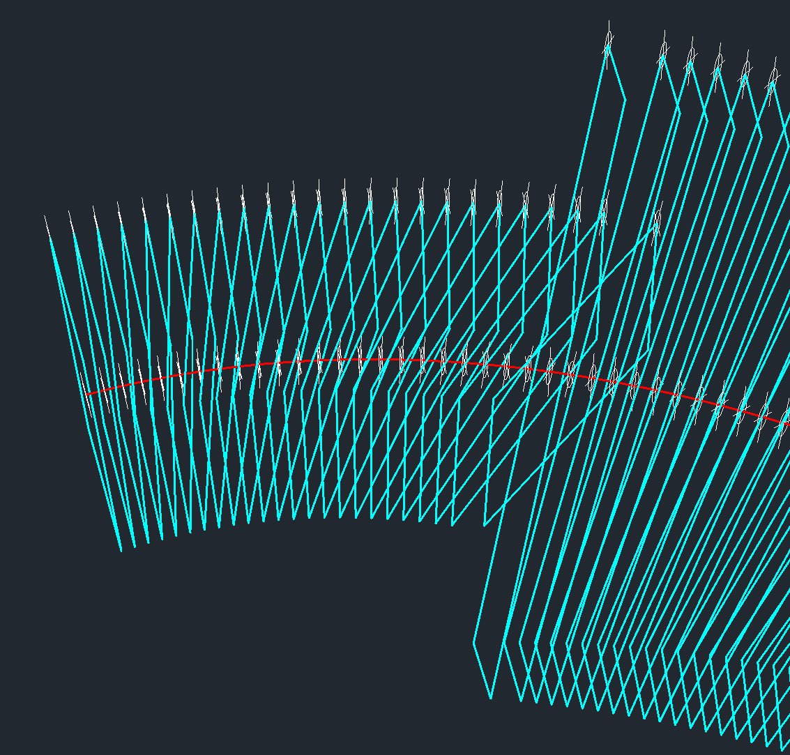

this is the moment it goes wrong...
even the selection preview looks fine...
than, if i continue, this goes on. Notice the pattern.
On the other hand... if you move the view enough to the left all goes fine...
The behavior is obviously view angle related.
What exactly is the click select recording?
the commandline output is...

uses same apparatus as select does (or?!)... at one point to the right it skips, latter on skips 2...
select works fine all the way trough by the way...
I have no idea why that happens nor how to prevent it... I do have an idea on how to avoid it...

@ibach  please post a copy of a file that contains the spline and the block that contains the section you want positioned along the spline.
My first impression is that there may be a discontinuity in the curvature of the spline.  It also looks like you are specifying way too many sections.  The loft command does not need a lot of sections to do a decent job.
I was solemnly testing the glitch with all those sections. It is a cool tool and i do like it, easy to use too.
It is obvious that a few well positioned blocks can do a wonder...
"discontinuity in the curvature of the spline" ... I used the same spline from the example you provided.
I still have no idea why on earth would selecting one block skip for the other or even two or three... I still haven't had enough free time, electricity and pace at the same moment to play with it...

I still can't imagine why, if the preview is ok, selection seems to be different... but...
It is not about the selection at all, it seems that the solution gets misapplied to the wrong block for some reason for the angle of the rotation is calculated well for the selected block, but gets applied to the wrong one latter on...
