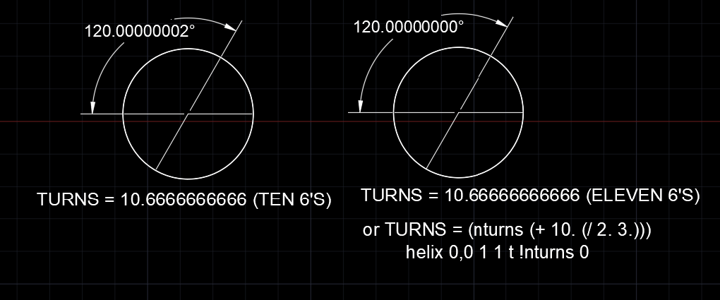

My first question was to determine what precision does AutoCAD use to store the number of turns of a helix.  The image below shows two helixes . Both have a top and bottom radius of 1.0 and a height of 0. The number-of-turns for the helix on the left is 10.6666666666 (ten 6's).  It shows an error of 0.00000002 for the subtended angle while the helix on the right shows the result of either using the explicit value of 10.66666666666 (eleven 6's) OR the result of a VLISP calculation.  These results indicate to me that vlisp calculations are to mote than 8 significant figures and probably more like 15 (the 64 bit floating point practical guideline).
I used AutoCAD's angular dimensioning features to measure the angles.  They have a display maximum  precision of 8 decimal places but coupled with the preceding 3 digits provide proof of at least 11 significant digits.
Bottom line?  I think you are safe using a VLISP calcuation for creating a helix to AutoCAD's maximum precision.

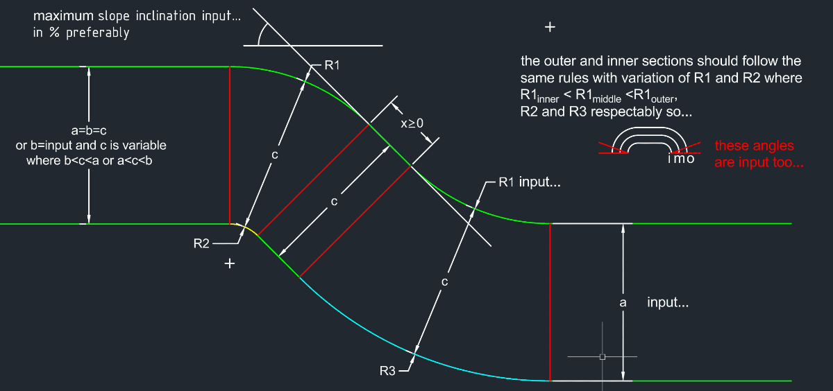

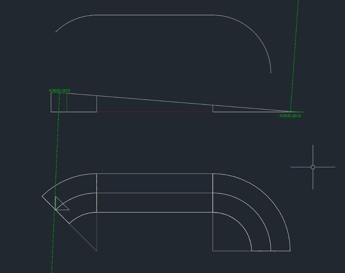

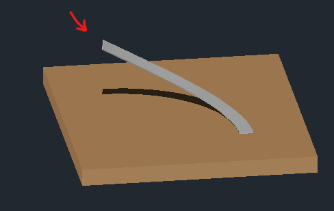

Now... The ramp above does not have an entry and exit slope with variable inclination...novarslope.thumb.png.a20de8f380fbb7a42ca56bceac21e3b6.png
I want to add variable slope at top and bottom...varslope.thumb.png.74289d36be54fd84e83bffe86a443bfd.png
Any ideas about correct geometrical approach are welcome!

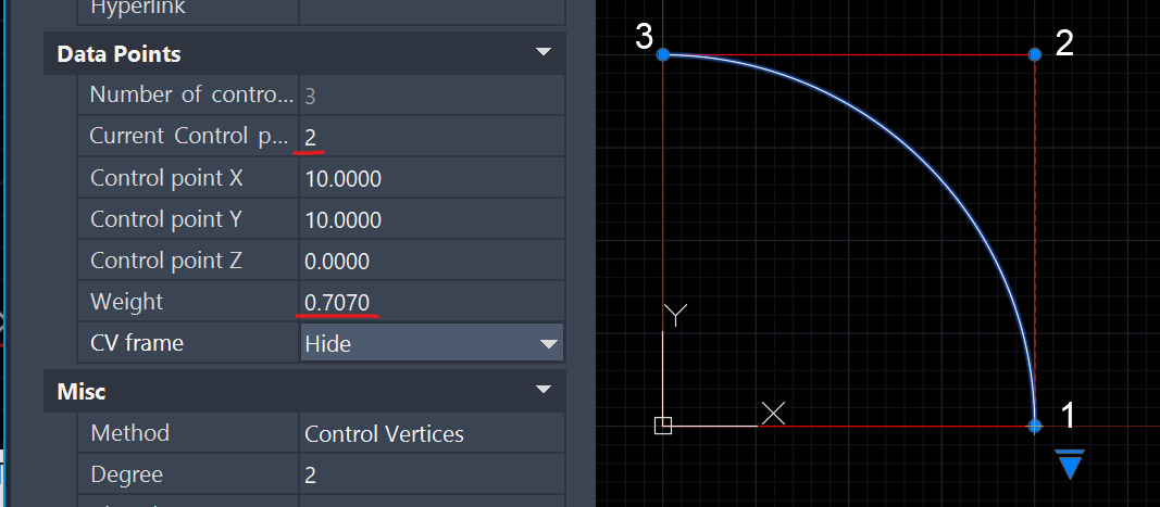

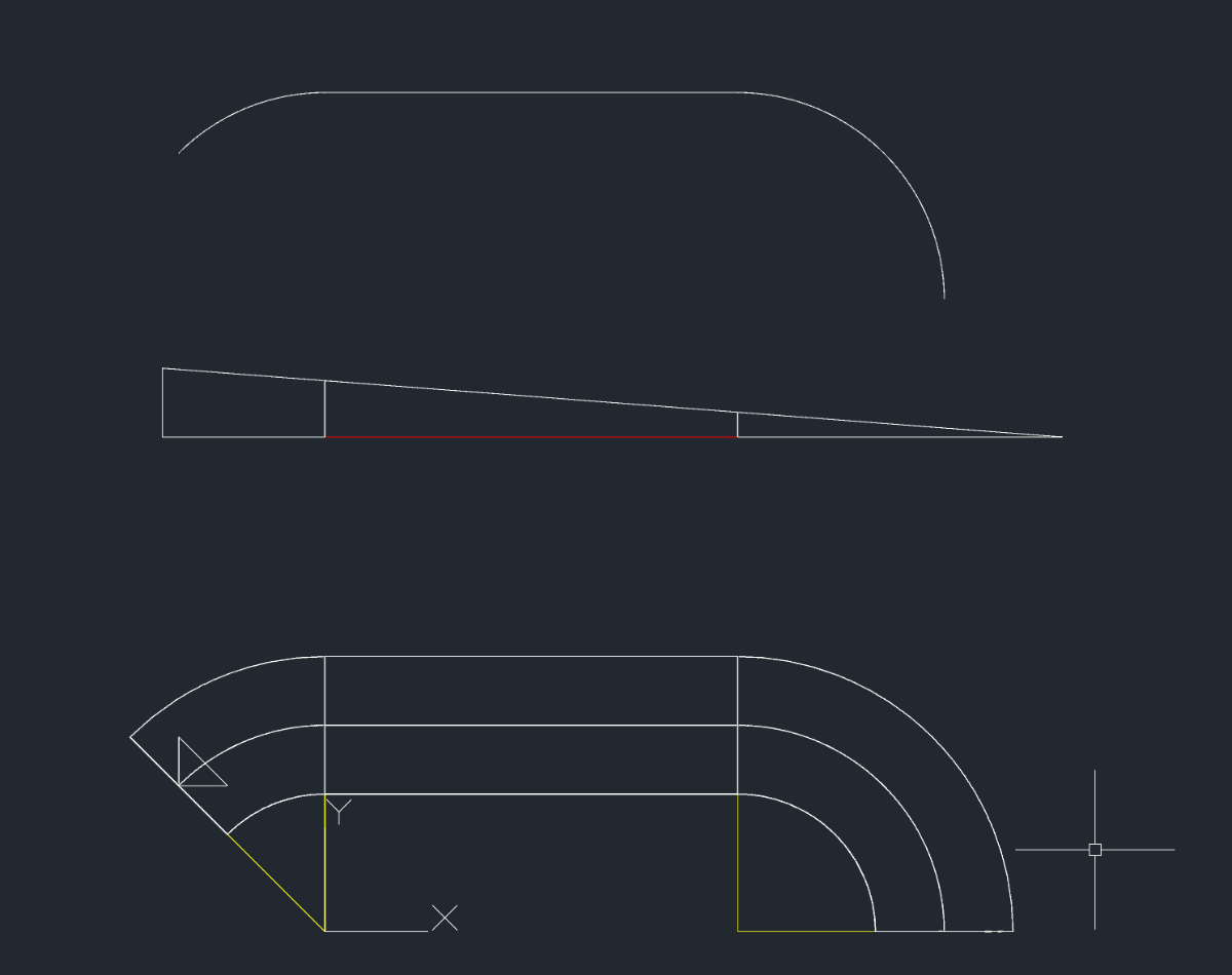

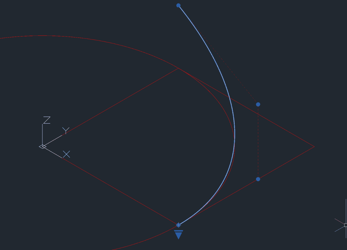

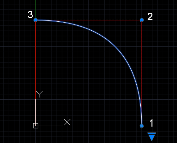

Let's assume that the centerline arc on the right in your drawing has a radius of 10. The curve starts wih z=0 and a slope of 0.0 and ends with z = 4.  Let's also stipulate that the slope at the end of the 90° bend is 30°.
Start by drawing a square 10 on a side.  To simplify construction place the bottom left corner of the square at 0,0.
Create a spline using the CV method (spline m cv) and define 3 CVs as noted using osnap end.
This splne is NOT a true arc.  To make an accurate arc change the weight of CV 2 to 0.707. I find that the easiest way to do this is to use the Properties panel.
You now have a true arc represeted by a spline!

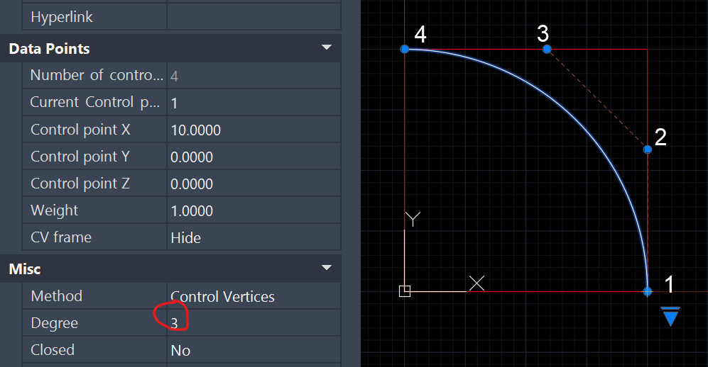

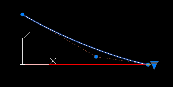

Change the degree to 3.  This will give us an additional CV to manipulate but will not change the shape of the curve.
Since we want to have a slope of 0.0 at the start of the spline we will leave the z coordinates of CVs 1 and 2 at z=0.  The first two CVs  and the last two CVs of a spline define the tangent vectors at the ends.
Set z = 4 for the CV number 4.
We now want to determine the z value of CV 3 that will yield a slope of 30° at the end (CV 4).
The properties panel indicates that CV 3 has an x coordinate of 5.8575. We know that:
tan(30) = H/5.8575 where H is the z difference between CV 3 and CV 4.
H = 3.3818 and the z coordinate of CV 3 is 4 - H = 0.6182.

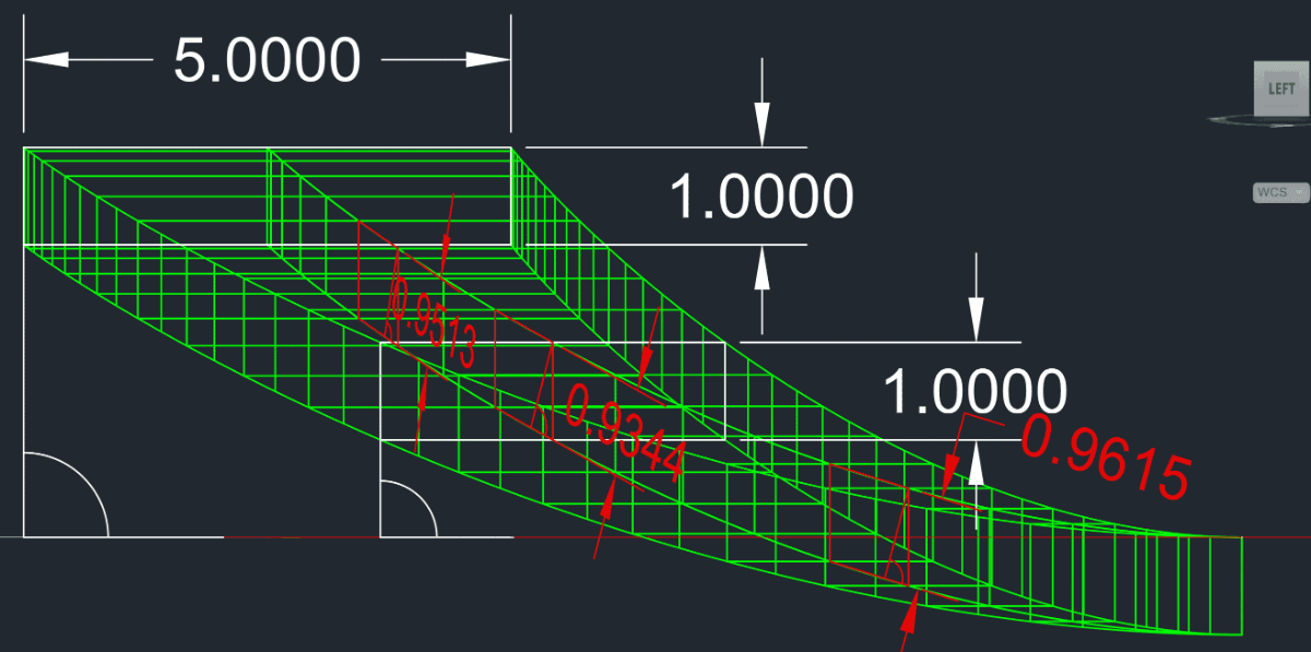

Setting Z = 0.6182 for CV 3 yields the following when viewed from the front.

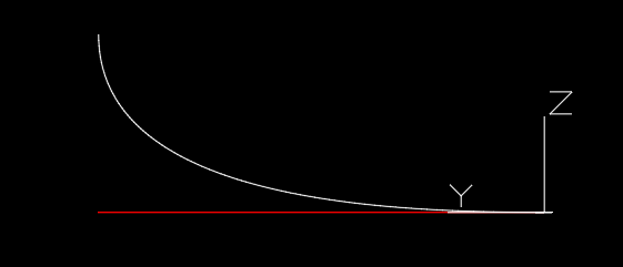

Here's a left view.

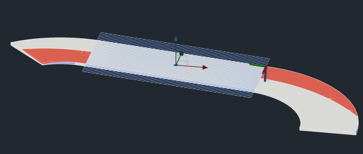

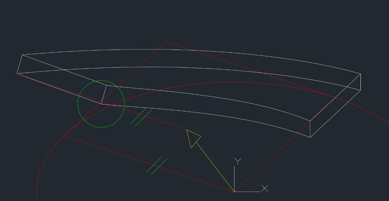

A rectangel is swept along the spline.  Note the unwanted twist at the end.
The following used a twist angle of 20° for the sweep operation.
The ramp is a gradually increasing slope ending with a 30° slope.  A similar approach can be used for the other arc end.

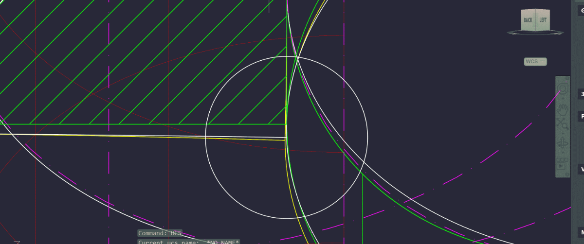

The reason I referred to my ramp solution as "cute"...
If you slice it by the plane trough the upper straight part of the ramp:
Obviously there is no tangent with the surfaces of the floors and the curvature of the ramp but in axes of the ramp...
Solution is satisfactory only as description and is a lousy geometrical model... but simple in its form and the file size is relatively small (I shall do a test here too), simple to extract data of the axes, the only level of description an architect would in practice ever need to produce...
Mathematically i hate it.
Representing both ends as tangential could be approached by the same method as you described... it is extracting data to think about latter on...
Never-mind...

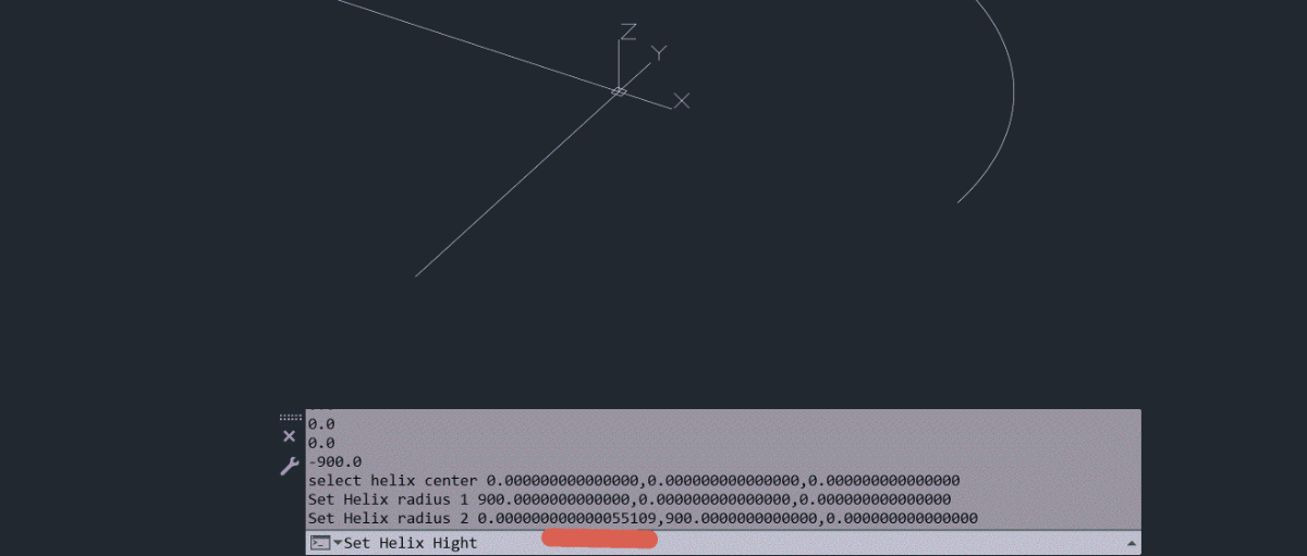

...In the meantime... I've noticed a strange behavior using my lisp...
Have a look at these two videos, please...
https://screenrec.com/share/WpTPbRfNjO
and
https://screenrec.com/share/Cpmc9aGvx0
and try to explain this error... It happens, no matter if i enter all the other coordinates manually and as integers, obviously... if i use trim and snap to pick a point on the end of this arc i get the error...  pay attention to command line in videos, input is manual and integers.
And, it happens no matter what... try it for yourself. I find it a bit strange... I mean... really?!
PS: I updated my lisp to use default Pi ...should have nothing to do with this, but here it is...

... Irm... I am still in wow with your solution... weight of CV 2 to 0.707 ... where did it come from exactly?

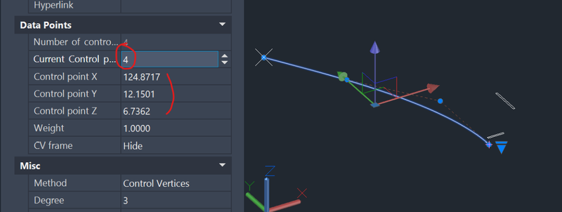

PS: How do i manipulate CV 4 in lisp... one more headache too :)

Check this link for where the 0.707 comes from.  It's the weight of a CV for a NURBS (sqrt(2)/2).
https://pages.mtu.edu/~shene/COURSES/cs3621/NOTES/spline/NURBS/RB-circles.html

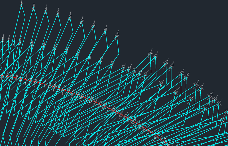

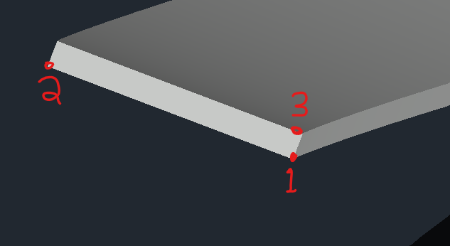

I wrote the following lisp to determine the needed twist angle.  The input is 3 points as noted.
(defun c:TwistAng  (/ p1 p2 p3 )
  (setq	p1 (getpoint "\nEnter point at start of edge. ")
	p2 (getpoint p1 "Enter point at other end of edge: ")
	p3 (getpoint p1
		     "Enter point on plane of end but not on same edge: "
  (setq	a   (unitv (mapcar '- p2 p1))
	b   (unitv (mapcar '- p3 p1))
	p   (mapcar '+ p1 '(0 0 1))
	da  (dot (mapcar '- p p1) a)
	pa  (mapcar '+ (mapcar '* a (list da da da)))
	db  (dot (mapcar '- p p1) b)
	pb  (mapcar '+ (mapcar '* b (list db db db)))
	pab (mapcar '+ p1 pa pb)
  (setq	v      (unitv (mapcar '- pab p1))
	ang    (acos (dot a v))
	angdeg (- 90 (/ (* ang 180.) pi))
  (princ "\nTwist angle is: ")
  (princ angdeg)

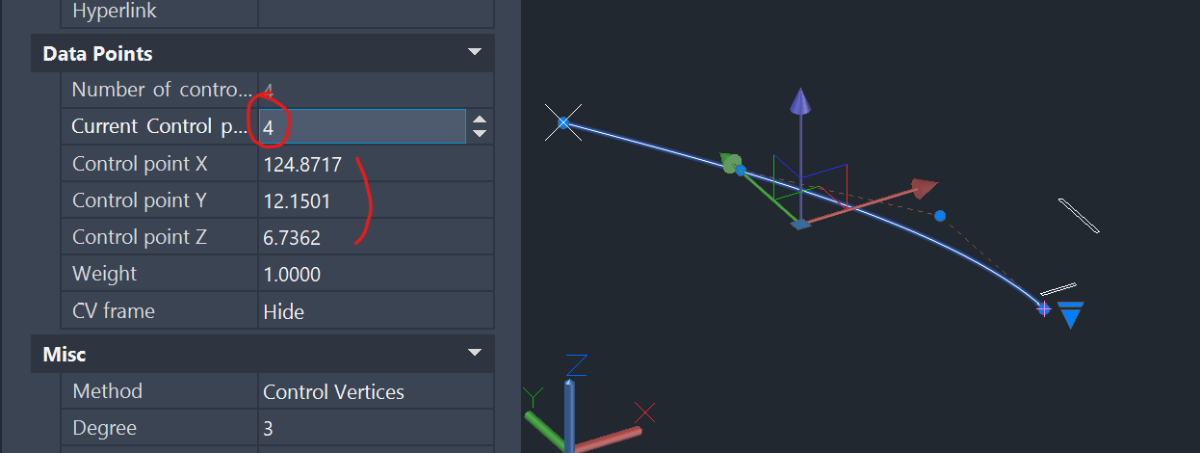

An easy way to edit the values of a CV (e.g., CV 4) is to use the properties panel.

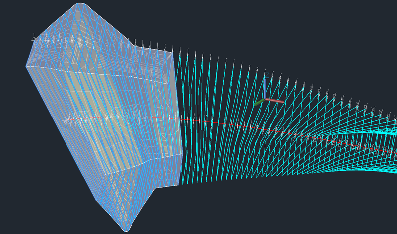

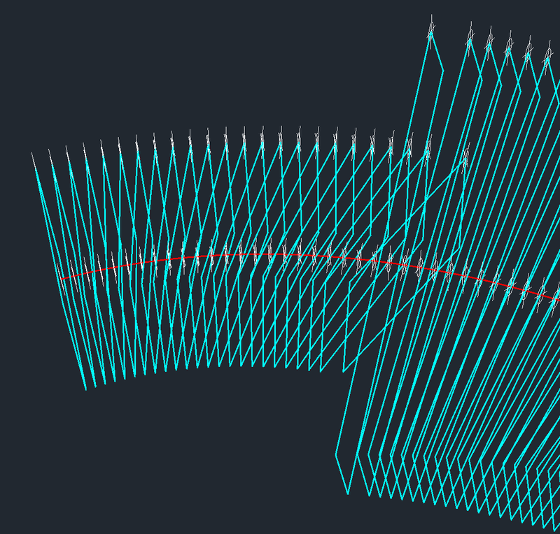

I don't have time to explain right now but sometimes I use the following LISP to create cross sections (that are defined by blcks) along a spline.  This approach allows the independent rotation of sections that are then used by the LOFT command.  It provides much better twist control than SWEEP.

@ibach your drawing has several solid ramps. They all look like reasonable solutions although some may not have the beginning and end slopes you want.  What changes, if any, do you wan to make?

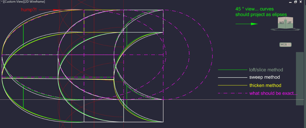

I am only looking for most "regular" solution... easy to describe,  for example
- this one, a vertical cross section is always a rectangle of same dimensions... its thickness  is irregular though... for the thickness to be regular i would need to rotate the curve under a bit...(clockwise in this case... and it would give me a strange detail at the upper end under the horizontal slab that i do not want)
- the white one i got sweeping the rectangle is not keeping the rectangle parallel to the ground nor the vertical crossection is always the same...
- the thicken method should be the solution, but it has the same problem as the above (its upper surface has no hump though and the upper side of the section rectangle is always parallel to the ground, lower surface has a deviation for it has to compensate for the thickens to be the same...)
... I am still looking for the result i really like the most and the method fast enough and easy enough and that describes easy enough to continue assembling some kind of a ramp drawing lisp aid...
Those are the possibilities i found to be giving some kind of acceptable result. None of which is actually perfect...
The first one does give me the easiest calculation latter on... (idealization of static model is easy)

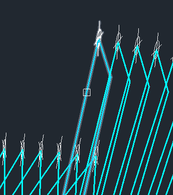

PS: the result of sweep command confuses me a bit... that hump simply should not be there... we are sweeping around spline, not the helix though... i guess it is for that approximation but i'd love to hear educated explanation.
Here is a 45° vertical section detail... the section rectangle in white and yellow case obviously does not follow the circular rotation of the top view rotating around its own vertical axes too and changing its width as it does so...45_view_2.thumb.png.755fbc5dff334bdf83d5a6604d352fdd.png
Edited by ibach

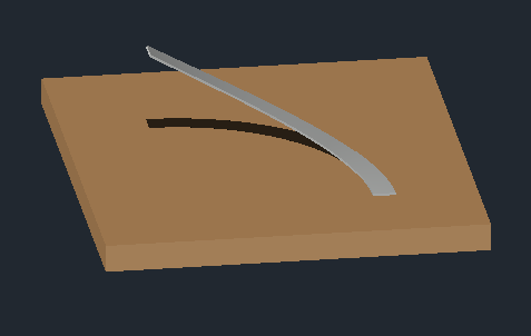

The actual shape i want should never have a hump in the upper surface, should never have a cross section height and the thickness smaller than the height of the horizontal slabs and should compensate for the detail in lover curves connecting the slabs to be in the right position without breaking continuity....
Something like this;
Edited by ibach
