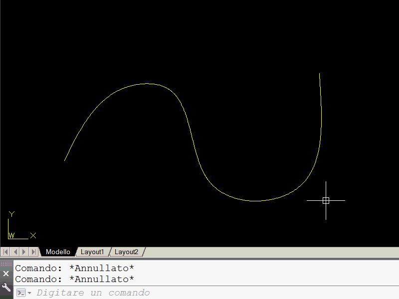

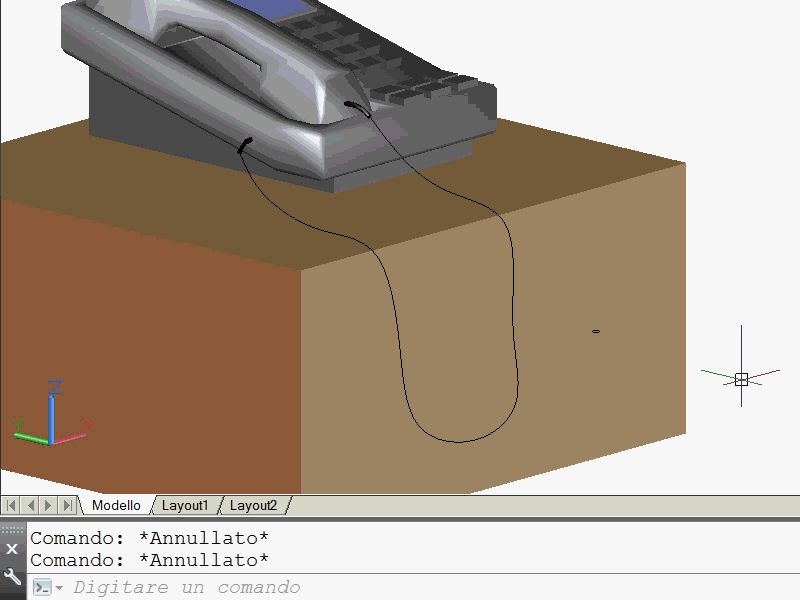

@thanks for sharing GP. amazing :)
  Lee Mac said:
Excellent work Gian, well done!
agree.. utilise geomcal.arx function nicely.
@ Lee
@ hanhphuc
@ Dadgad
Thanks, I am very happy that you like it :)
Congrats!
I made something similar way back when. I had various rope / cable / hoses / IBeams as profiles. Pretty cool but limited to 255 vertices meshes.
I remember it being a pretty intense project. Your final products look very good -David
Thanks SLW210
Thanks David
Thank you all for the flattering comments. :)

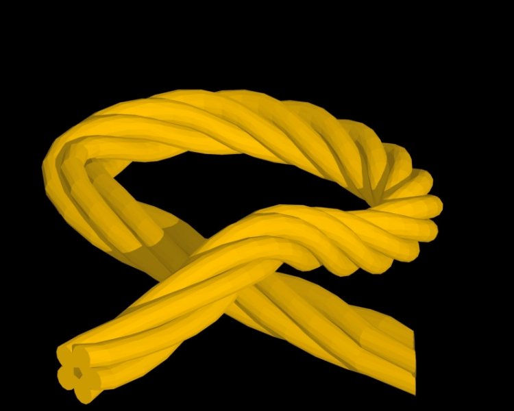

  GP_ said:
The code is not so nice but, for my use, it seems to work.
Ciao
[ATTACH=CONFIG]51161[/ATTACH]
[ATTACH=CONFIG]51162[/ATTACH]
[ATTACH=CONFIG]51163[/ATTACH]

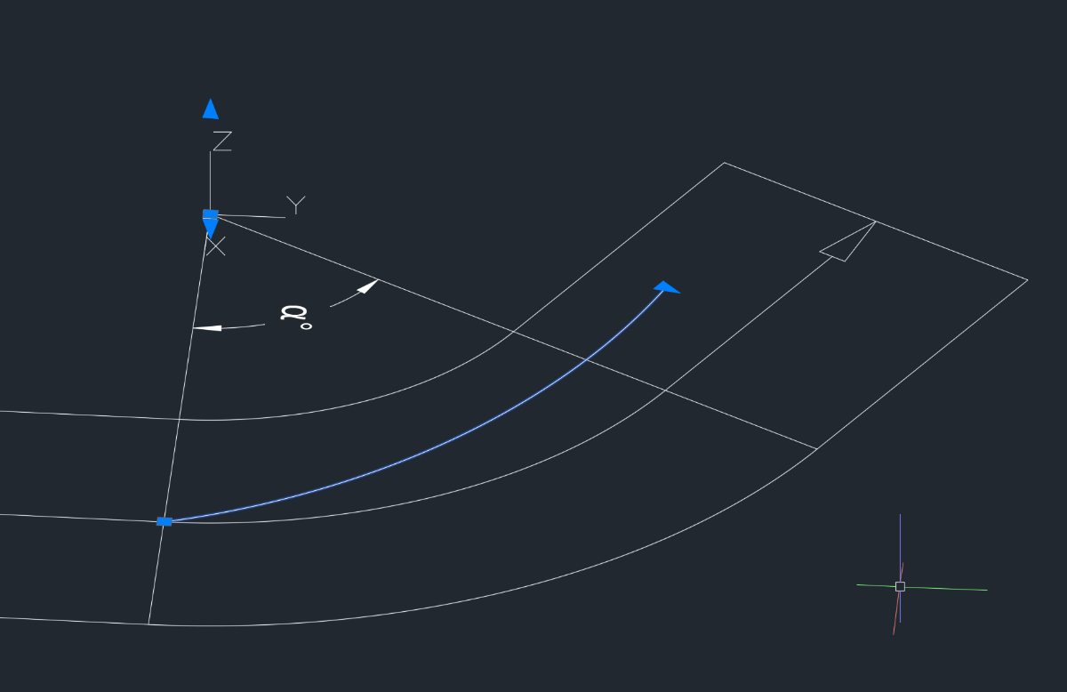

Helix tool in AutoCAD seems to be the best way to draw a ramp in 3D... The only thing it is missing is the possibility to enter number of turns by selecting the angle of the ramp that is circular... To do that i need to measure the given angle and manually calculate number of turns (<1) and input the number back to helix properties... see the picture, please... I would love to have a lisp that would allow that input selecting the two lines defining alpha... e.g. if α=60, the number of turns is 60/360=0.16666667  which i would not like to be only 8 decimals but the max of accuracy AutoCAD can achieve...
Can anyone help with that?

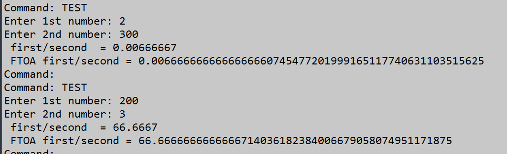

@marko_ribar  Very interesting!  I thought that AutoCAD would carry the approximately 16 significant figures (per the 64 bit floating point standard) for all floating point calculations. It looks like the results are only to 6 significat figures.  Why?
I tested your code with the following results.
(defun c:test (/ d e f g)
  (setq d (getreal "\nEnter 1st number: "))
  (setq e (getreal "\nEnter 2nd number: "))
  (setq f (/ d e))
  (princ "\n first/second  = ")
  (princ f)
  (setq g (ftoa (/ d e)))
  (princ "\n FTOA first/second = ")
  (princ g)
(defun ftoa (n / m a s b)
  (if (numberp n)
      (setq m (fix ((if	(< n 0)
		     n
		     1e-8
      (setq a (abs (- n m)))
      (setq m (itoa m))
      (setq s "")
      (while (and (not (equal a 0.0 1e-6)) (setq b (fix (* a 10.0))))
	(setq s (strcat s (itoa b)))
	(setq a (- (* a 10.0) b))
      (if (= (type n) 'int)
	m
	(if (= s "")
	  m
	  (if (and (= m "0") (< n 0))
	    (strcat "-" m "." s)
	    (strcat m "." s)
I'm getting old....
