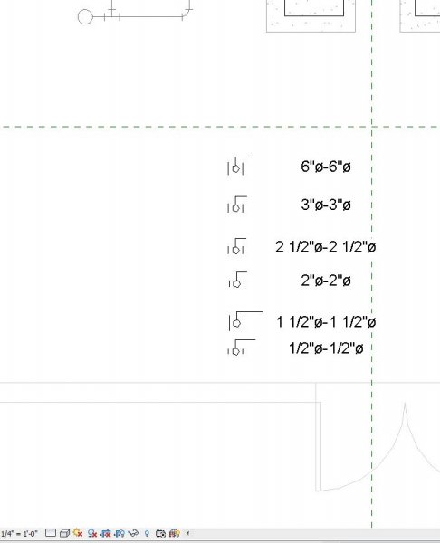

wildirish317 Posted October 3, 2014 Posted October 3, 2014 I'm at a point where I can model a piping system in "Fine" detail level that our installers can use. Now, I'm trying to use Revit to produce single line (Course or Medium detail) for our estimators, to make it easier for them to do take-offs. Below is a screen shot of out-of-the-box Revit ball valves in Course detail. Can someone tell me why the smaller valves are "out of whack"? It has to be how the model lines are locked in the family, but I'm having trouble determining what's locked to what. I can probably fix these by copying the 2" Family Type to the 1-1/2" Family Type and then change the size parameters back to 1-1/2", but that won't teach me why these model lines behave the way they do. Any feedback will be appreciated. Quote
tzframpton Posted October 3, 2014 Posted October 3, 2014 You will have to dig into the Valve Family and reverse engineer how the model lines are set up. Also, annotative scaling for schematic objects (in Mechanical Settings) can have adverse effects on this. I have edited the valves I use most often, which aren't many. But it's almost required in Revit. Kind of a pain if you ask me, but to Revit's defense... EVERY company shows valves and schematic objects differently. Trying to use 3D models to represent a schematic 2D layout is, and will never be complete. Quote

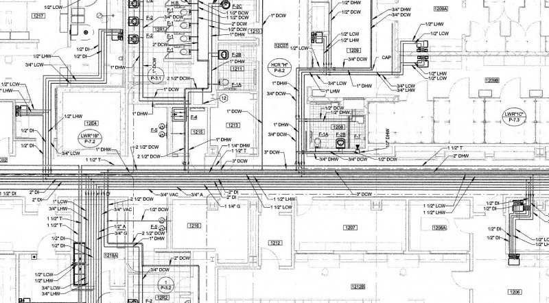

wildirish317 Posted October 3, 2014 Author Posted October 3, 2014 That looks pretty good. Here's a sample of what our estimating department is struggling with now. These smaller pipes at 1/8" scale are hard to follow: Fortunately, the engineers included risers to aid in telling what goes where: Still, it's difficult to follow on a scanned pdf file. Quote

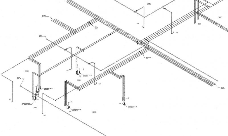

tzframpton Posted October 3, 2014 Posted October 3, 2014 I'm a huge fan of single-line schematic piping. It's clean, easy to follow and well organized. The problem with Revit is this: if you model realistically then your schematic single-line display will suffer immensely. So you have two options: use Piping in Revit as "3D pipes" in a "2D world". No offsets in elevation, no coordination efforts at all, and no realistic piping types, valve placements or fittings. Just run the pipe as if you were running 2D linework and that's it. As soon as you want to use Piping in Revit as a realistic routing and coordination effort, then forfeit the schematic view, start using enlarged views everywhere necessary, and use tons of Sections and Elevations with Section Box 3D Rendered Views (as shown in my example PDF linked above). Either way you choose is up to you, but one thing is for certain, again I reiterate: realistic 3D pipe routing and coordination will never get you clean 2D single-line schematic Views no matter how hard you try. Choose one or the other, not both. Hope this helps. And thanks for the compliment, maybe they can inspire you to some degree. Quote

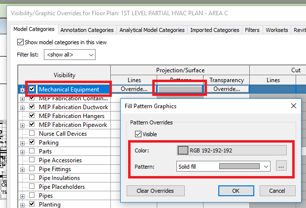

bpark8824 Posted August 21, 2017 Posted August 21, 2017 tzframpton - how are you able to make all your mech equipment gray like you have, I like the way that looks. Quote
bpark8824 Posted August 21, 2017 Posted August 21, 2017 Awesome, thank you. I had the color set to gray but forgot to set it to a solid pattern. We've been using Revit in house for a year now and I've also struggled a lot with single line drawings. We used to always have a standard of 2-1/2" and over (flanged) would be shown in 2-line and anything smaller would be single line however this has become more difficult with Revit. Quote
