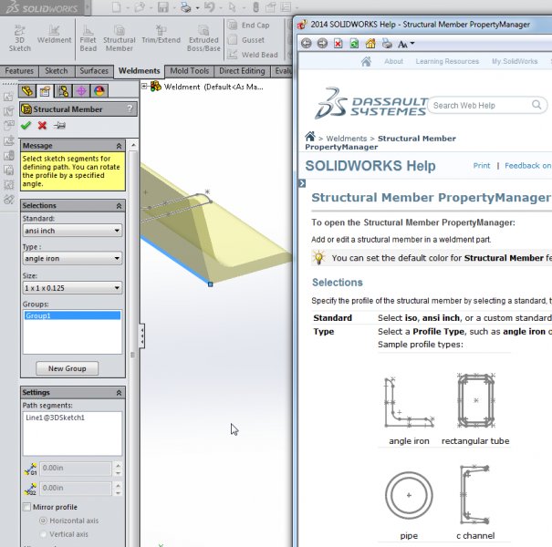

I recommend going through the built-in Tutorials, in this case the Weldments.

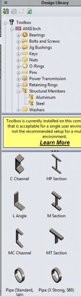

You might also see what you can find in the Toolbox.
