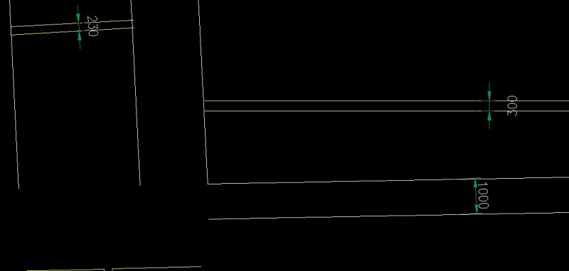

Hi Guys attached drawing is of a beam layout.
Iam suppose to Make Center Lines for all beams.
And there are still 12 Floors of the same size :shock:
Hate doing boring stuff like this which are time consuming but equally importantpart of my job so.
Any way for speeding up process would be highly helpful.
Thank you.
new block.dwgFetching info...
Draw 3 lines in first go put c/l on a different layer
Heres a lisp that takes a line and makes two new lines just remove the erase bit and c/l will stay just edit the defuns for edge beam sizes

Sorry for the late reply guys, stuckup with work at construction site got to desk now.
@BIGAL thanks mate but i was not able to get it to work. removed this part
(command "Erase" obj "")
then edited this line to beam size corresponding in my drawing. mainly 230mm, 300mm and 1000mm
Example : edited this line in the code to
(defun c:P450 () to (defun c:P230 ()
(pipeoffset 0.265) kept this line the same, think has to change.
saved the text as .LSP loaded it and typed in p230 it asked to pick a line i was like iam getting some where with this for a fraction of second and then when i select a lin :oops: An error has occured.
and with my LISP skill of apploading and typing the command i think iam back to ask help again :cry:
@ SLW210 : Thanks i found some lisp around on the internet which are very similar to the lisp posted on that thread. cpoly by Lee mac is a great one perfect for any shape of polylines. just picking the line first line and then the second line in my case is still time consuming i increased the pickbox size for easiness, but still iam spending aroung half hour to 45mins . being able to select two lines with a marquee selection would really help cutting the time down i guess. i reached this page
http://www.afralisp.net/autolisp/tutorials/selection-sets.php
hoping to learn and edit the selection to marquee style and realized it takes more than that alone :ouch:
lee cenlin cpoly.lspFetching info...
The problem will be the linetype in the code I draw using a particular one. I have changed the code it should now draw in current linetype look at the lines with semicolon ; at start. The ; means remarks and what comes after it does not run.
Sir BIGAL i dont understand what you said :(

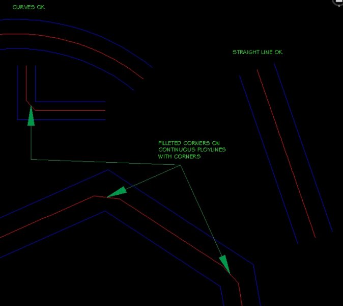

Was continuing making the centerlines with Lee Mac's Lisp for center lines but hit a glitch. it works fine with straight lines, curved lines, inclined lines, but when i used it on angled continuous polylines i get the corner filleted. attached image and the LISP code Below. Please help.

Thanks for guiding me to the Thread marko_ribar , Helped a lot :thumbsup:
You're welcome... If you don't have A2011+, maybe try this code... Picked LWPOLYLINES must be correct offset pair (the same number of vertices)... It should work and in some other UCS, just you'll have to set up UCS to be parallel with reference LWPOLYLINES...

maybe need to approach ARC... (after exploding some are ARC)
Selections need be careful due to it compares each pair , so must not select all at one time
select partially better. Marko's routine works on parallel ,so i try my best to make it more generic which allow not parallel lines.
command: OFFCL
1.pick the entity for matched layer
2.dist to be ignored during compare
3.select Lines
Edited by hanhphuc
image & comments
My Gosh!!! hanhphuc this is incredible. Sad Iam Unable to make it work. Iam using Acad 2013.
Here is what iam doing.
1. I Didn't want any confusion regarding layers so brought everything to one layer.
2. Didn't want any confusion regarding type of lines so used MPEDIT and converted all lines,Arc's to Polylines. so now i have only Polylines in the drawing.
3. Apploaded the LISP
4. Entered OFFCL
5. Program asks Pick matched layer entity..
6. At this point i dont know what iam suppose to do exactly. so i pick any random line
7. Program asks . Ignore short length, approx ? :
8. at this Point i don't know what iam suppose to do. i just select two points along length of a random line like shown in your demo in the GIF.
9. No the cursor changes and program asks to select object. i try selecting like shown GIF above. but nothing is getting selected. and no center lines created.
hi suryacad, if the joined LWpolyline has difference vertex that would be quite challenging that's why currently i just test for LINE, i'll try to tweak for arc offset soon.
