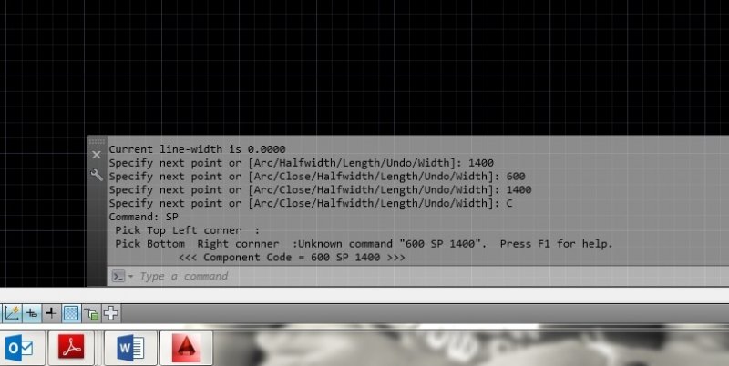

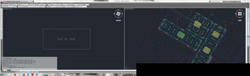

Hi All,
i have attached here in a screenshot of the error in Autocad 2014. i have also attached the actual attribute the command should show using Autocad 2013.
link of lisp file:
https://www.dropbox.com/s/vva5y7psu0iv2ue/CADSRV.rar?dl=0
im not familiar with lisp programming so i hope someone can help me out with the errors i'm having.
Thank You,

The screenshot i showed is just one of many commands i have on my lisp routine file.
But as i have checked most of my commands comes out with an error on 2014 version.
Thank You

The lisp file is already attached as a link... im having errors attaching my file maybe its to big. so i used my drop
box instead. to elaborate on my problem. i use the lisp to generate codes (attributes) for the design of formworks on
structures, so basically it assigns attributes to a specific size of formwork. based on my attached screenshot. i used
a rectangle sized 600 x 1400 mm. so when i want to attach an attribute to this i use of the commands on the lisp
depending on what i want the attribute to be. on the screen shot since the size is for slab form i used the command
SP. the lisp gives and instruction to click the top left corner. and next instruction is to click the bottom right
corner. after that the lisp will generate an attribute like "600 SP 1400". this was fine 2013 and below versions.
comes 2014 doing the same procedures. now the lisp will give an attribute of "S1". lisp will give the same set of
instructions but after clicking the bottom right corner it will now show unknown command "600 SP 1400".

I would guess that is about a call of a command whose syntax had changed in release 2014. To track it down may enable the echo of prompts by locating in you code the statement below:
(setvar "CMDECHO" 0)
and changing it to:
(setvar "CMDECHO" [b][color=magenta]1[/color][/b])
After call again the tool and check on which command call it fails; adjust it by the new prompts or evaluate the usage of INITCOMMANDVERSION function.
PS. By the way, perform the search for CMDECHO only since the syntax of said assignment may vary.
