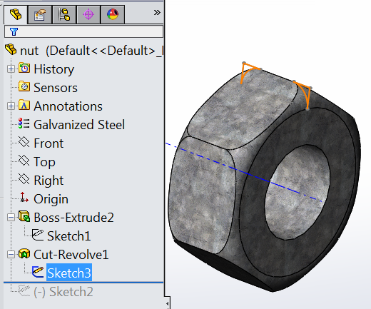

Nut using revolved cut
Hi.
I have been given a drawing (attached) where it is obligatory to use the revolved cut function to "smoothen" the edges of the nut. However, I cannot for the life of me figure out how to do it. Attached is my part with the contours I thought were correct.
As usual, the zero-thickness geometry is one of the problems I encounter. Even when I do not encounter this problem, the nut looks nothing like the drawing.
nut.SLDPRT
You put your Sketch2 on the wrong plane - it should be on the Front plane at the corners.
Thank you again, Mather! I will try it right away!
Ahhh, I finally manged it! Thank you so much!
