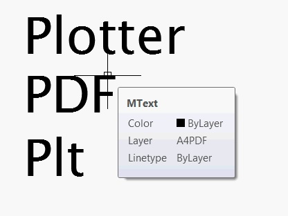

steven-g Posted September 24, 2014 Share Posted September 24, 2014 OK first thankyou for this question, it got the old grey matter working. Try this code it will no doubt fail but it's a starting point, this does have a few requirements from you first, for each PageSetup name, make a new layer and name it exactly the same (if you have spaces it might not work), on each layout put 3 mtext items with the text "plot" "pdf" "plt". Change the layer of each text to match the PageSetup for that particular layout. I'd just do one layout and 3 layers as a test. If this works you can create a template file with everything setup later. Next try set macrotrace=1 then run this macro, if it works yippee, it won't so after running it copy the command history and post it here. When the macro runs it should pause - at this point you need to click one of the text items depending on which device you want - it uses the layer name to use as the PageSetup. It works here but I don't know your system or the names used ^C^Csetenv;temp;$m=$(getvar,clayer);laymcur;\setenv;temp1;"$m=$(getvar,clayer)";clayer;"$m=$(getenv,temp");-plot;n;;"""$m=$(getenv,temp1)""";;;n; This shows what I am trying to explain - the word PDF is on the layer A4PDF and A4PDF is the name of the PageSetup for an A4 PDF Quote Link to comment Share on other sites More sharing options...
Taurenis Posted September 25, 2014 Author Share Posted September 25, 2014 Haven't used "setenv" "temp" etc. before. It's a whole new world to explore 1) the code works 2) unfortunately only on LT (I'm using full ACAD myself and some of my collegues are as well) 3) spaces do cause a problem (ACAD interprets it as "enter") 4) for pdf and plt I would suggest adding "~;" at the end of the code, just before last "n" (that brings up the "Save" dialog box) ^C^Csetenv;temp;$m=$(getvar,clayer);laymcur;\setenv;temp1;"$m=$(getvar,clayer)";clayer;"$m=$(getenv,temp");-plot;n;;"""$m=$(getenv,temp1)""";;;~;n; If this was only the first step, I'm ready to hear out the next one. If this was the final solution, I must admit that it's not what I was looking for. I don't want the user to make any other choices but the file name and final question about plotting after the user has pressed one of the buttons (plot/create pdf/create plt) Quote Link to comment Share on other sites More sharing options...
