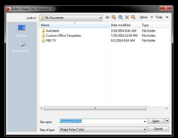

how can I load via shape command? and how to save in path directory ?
Sorry, I should have said use the LOAD command not the SHAPE command. I corrected my post.
Options > Files > Support File Search Path > Add > C:\ program files\ autodesk \ autocad 2012 \ folder name where your shape files are located goes here.
