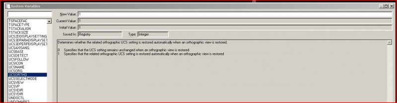

Dadgad Posted September 22, 2014 Share Posted September 22, 2014 Welcome to CADTutor. It sounds like your UCSORTHO system variable setting, for which I believe the default value is 1, has been changed to 0. As described in the screenshot from the SYSVDLG description of system variable options. I hope that helps you. Quote Link to comment Share on other sites More sharing options...
