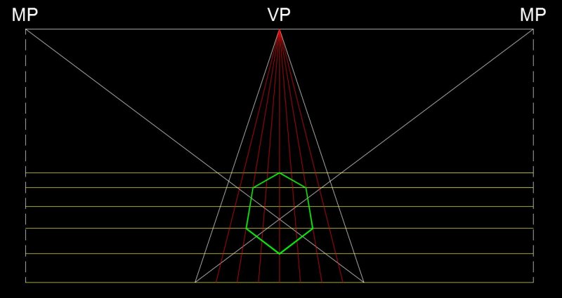

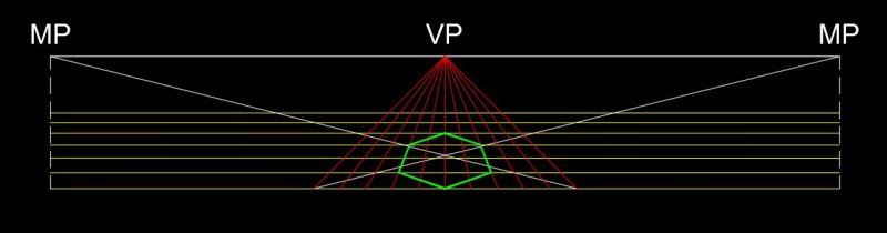

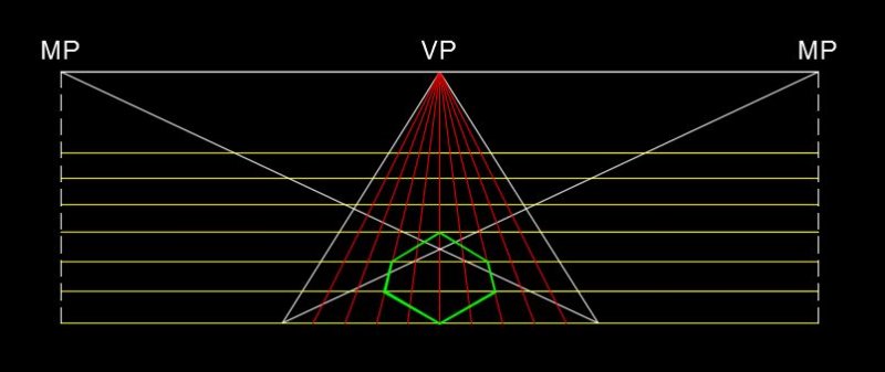

ReMark Posted September 19, 2014 Posted September 19, 2014 (edited) No it doesn't. It was meant as an example of the basic principles for drawing a 2 point perspective. Quick example: It's all a matter of setting up your Vanishing Point and Measuring Points. Adjust one or both to achieve the desired affect. Given some thought about what happens to the shape of your object as you adjust these two parameters. A change of perspective: Now it's your turn. Experimentation can be fun. OK, one last try then I'm done. Is this closer to what you had in mind? See how the polygon has flattened out? Edited September 19, 2014 by ReMark Quote

basty Posted September 19, 2014 Author Posted September 19, 2014 ReMark said: No it doesn't. It was meant as an example of the basic principles for drawing a 2 point perspective. Quick example: [ATTACH=CONFIG]50994[/ATTACH] It's all a matter of setting up your Vanishing Point and Measuring Points. Adjust one or both to achieve the desired affect. Given some thought about what happens to the shape of your object as you adjust these two parameters. A change of perspective: [ATTACH=CONFIG]50995[/ATTACH] Now it's your turn. Experimentation can be fun. OK, one last try then I'm done. Is this closer to what you had in mind? [ATTACH=CONFIG]50996[/ATTACH] See how the polygon has flattened out? Thank you for your effort. However, I still do not understand. Would you please send me an understandable step by step with its construction line? Quote

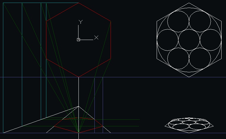

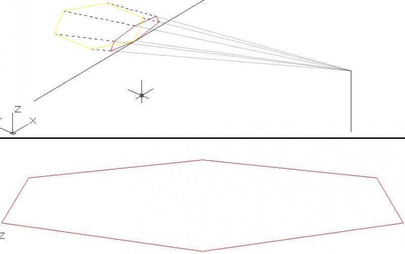

SEANT Posted September 20, 2014 Posted September 20, 2014 (edited) This demos one of the typical ortho- to perspective transforms. The right demos another lazy method by using STSC_Projective2D Exchange app to handle the circle transforms. HexPerspective.dwgFetching info... Edited September 23, 2014 by SEANT Numerous Quote

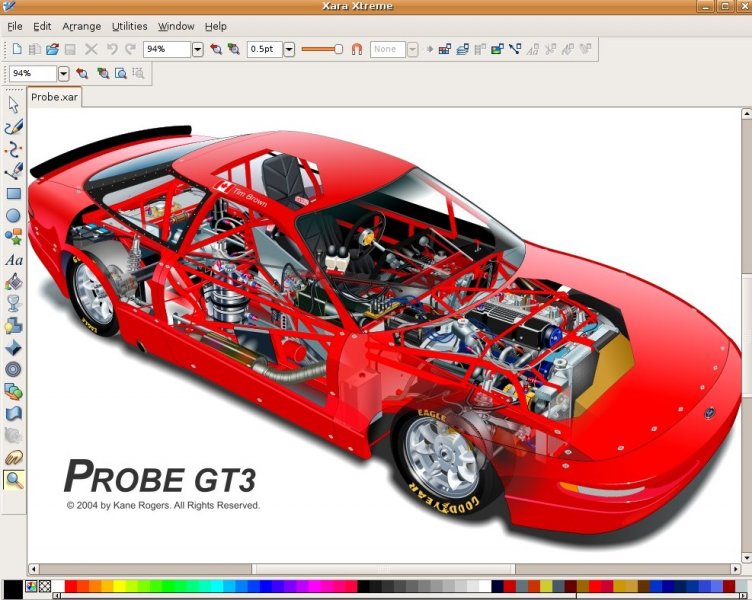

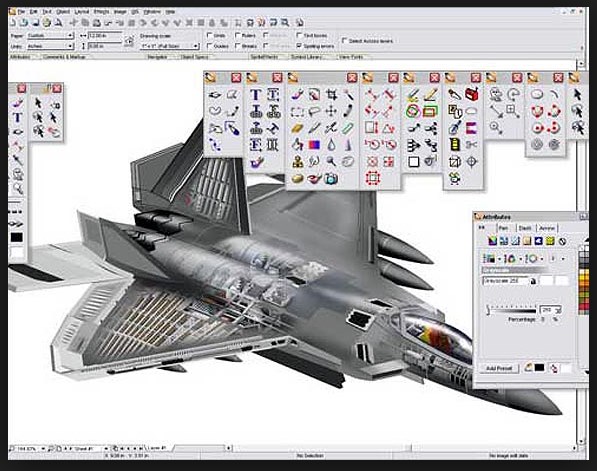

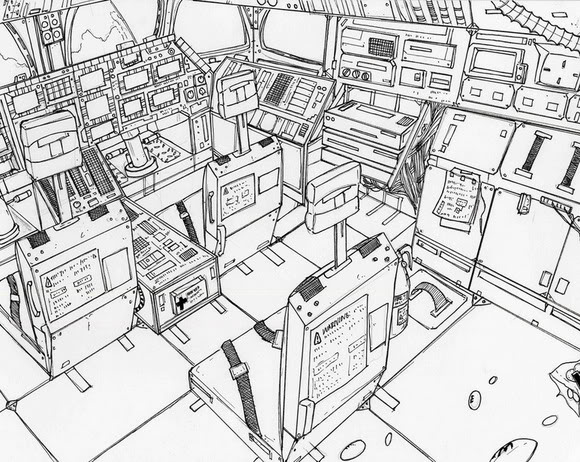

basty Posted November 17, 2014 Author Posted November 17, 2014 I actually never being taught a projection like this in my college. The only projection being taught are isometric and dimetric. I am a mechanical engineering myself. I wonder where was this lesson is taught? In school or college? Would somebody teach me this projection? I still not be able to construct a polygon into this kind of projection. Would somebody tell me in detail to construct a polygon to this projection? I would like to be a draughtsman artist which able to create such as below illustration: Quote
tzframpton Posted November 17, 2014 Posted November 17, 2014 The car you posted was not created by a drafting program, but a hand-drawn illustrator program (my best guess anyways). AutoCAD would be the last program you'd want to use for an illustrated image such as the transparent car body image from above. Quote
