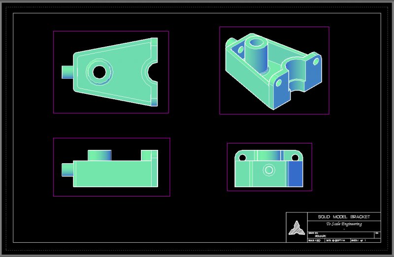

ReMark Posted September 16, 2014 Posted September 16, 2014 Michael: If you would be so kind as to attach a copy of one of the drawings to your next post someone here will take a look at it. The drawing really only needs to have one 3D model in it to be useful. In my opinion your title block and border belong in a layout. Your 3D model would be viewable in the layout if you use one or more viewports. The problem is your model space annotation, both text and dimensions, should be annotative since I am guessing you'll be wanting to print to some sort of scale. However, without a sample drawing, this is all conjecture on my part. Quote
ReMark Posted September 16, 2014 Posted September 16, 2014 An example of a layout with four viewports showing a top, front, side and isometric view of a 3D solid model. Sorry, but I didn't have time to add dimensions, etc. The title block and border, in white, are on their own layer and only exist in the layout. They are not in model space. Understand? The viewports are those magenta colored rectangles. They are on their own layer and the layer has been set to "no print". The viewports all have a scale of 1:30 (it was a metric drawing) but when it comes time to print we do so at a scale of 1:1 (1 unit = 1 millimeter). Quote
