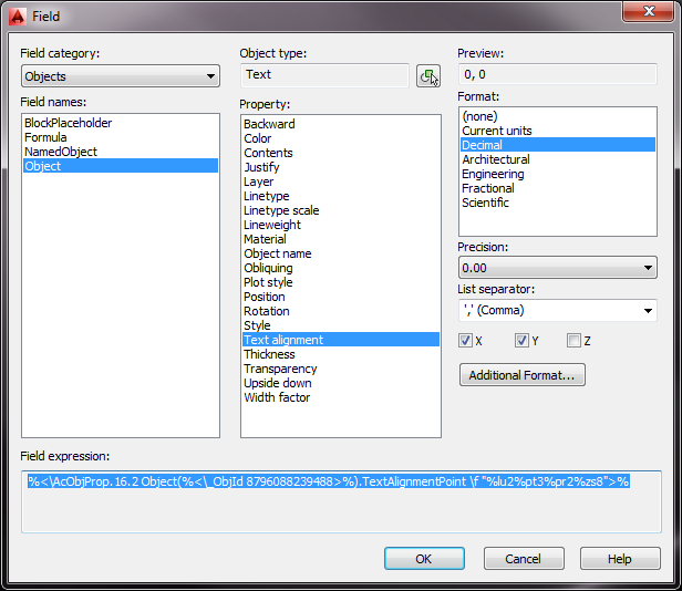

srksphillips Posted September 15, 2014 Share Posted September 15, 2014 Last week I created a dynamic block that contained Text objects (with inserted Fields) that displayed each Text Object's position within the Block. In other words, my Text objects displayed their own X or Y position as relevant. I had re-opened the drawing several times that day and everything worked fine. I opened the file today and all the fields contain ######. DYNAMIC BLOCK USE: Dynamic map grid DESCRIPTION: Combines a Linear Parameter with an Array Action that arrays the grid lines and their position labels. Once the block is setup it is exploded and regenerated - the labels then display their positions within the drawing. FIELD CONTENTS: Each grid label is a field that looks at its own Text Alignment X or Y position. I set this up by copying and pasting a Field Expression into the formula entry area. As you cannot select the Text Object you are currently in, I used dummy text fields to find the Field Expression I needed for the desired Text Object. Does anyone know why my dynamic blocks work fine one day and not the next - this has happened for some of my other dynamic blocks. When you edit the fields the formulas have gone. Any help would be greatly appreciated - thanks in advance. Quote Link to comment Share on other sites More sharing options...

srksphillips Posted September 15, 2014 Author Share Posted September 15, 2014 This is an example of what should be contained in one of the the fields: %%).TextAlignmentPoint \f "%lu2%pt3%pr2%zs8">% I paste the Field Expression I want into the relevant label. E.g. If I need Label A's position I create a dummy Text object (B). From within B I get the Field Expression for A's position and copy it. Then I open up A and paste the Field Expression into the Formula. Quote Link to comment Share on other sites More sharing options...
srksphillips Posted September 15, 2014 Author Share Posted September 15, 2014 Oops - should only be X or Y ticked in the image, not both. Quote Link to comment Share on other sites More sharing options...
