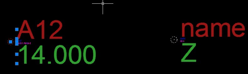

Costinbos77 Posted September 12, 2014 Posted September 12, 2014 (edited) Hello! I've tried to define an attribute with LockPosition on through dxf code and does not work. (entMake '((0 . "BLOCK") (2 . "PunctT") (70 . 2) (8 . "0") (10 0 0 0) (6 . "ByLayer") (62 . 256) ) ;_ end of e . . . (entMake (list '(0 . "ATTDEF") lStrPn '(10 0 0 0) '(70 . 0) '(1 . "") '(2 . "DENUMIRE") '(3 . "Dati DENUMIRE Punct : ") '(40 . 1.5) '(11 0.5 1. 0) '(72 . 0) '(74 . 2) '(6 . "ByLayer") '(7 . "Arial") '(62 . 256) [color="red"]'(280 . 1)[/color] ) ) (entMake (list '(0 . "ATTDEF") ..... [color="red"]'(280 . 1)[/color] ) ) (entMake (list '(0 . "ATTDEF") ..... [color="red"]'(280 . 1)[/color] ) ) . . . (entMake '((0 . "EndBlk")) ) ;_ end of e Note: DXF code 280 , is not available for AutoCAD version 2006 or lower. It requires the same sequence '(280 . 1) when inserting block ? (entMake (list '(0 . "Insert") '(2 . "PunctT") lStrPs '(66 . 1) (list 10 x y z) lScBpX lScBpY lScBpZ) ) ; insert . . . (entMake (list '(0 . "ATTRIB") (list 10 x y z) lStrPh (cons 1 text) '(2 . "COTA") (list 11 x y z) [color="red"]'(280 . 1)[/color]) ) ; set . . . (entMake '((0 . "SeqEnd")) ) ; End Does anyone have any ideas? Thanks in advance, Costin Edited November 20, 2014 by Costinbos77 Quote

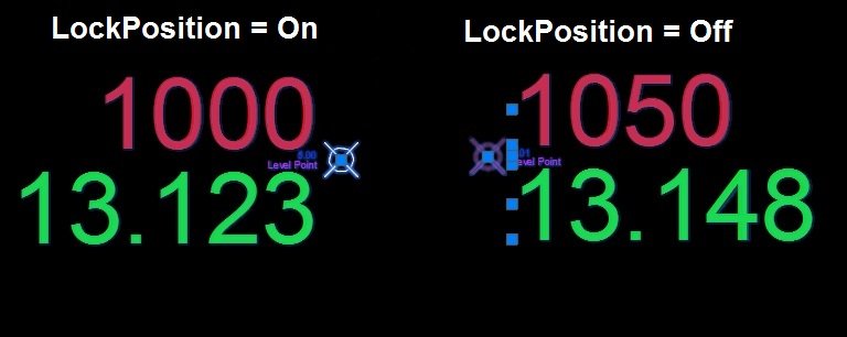

Costinbos77 Posted November 20, 2014 Author Posted November 20, 2014 (edited) Can't be from an AutoCAD variable "AFLAGS" , setting must be for an individual attribute, not global for entire drawing . (setq attributeObj (vla-AddAttribute modelSpace attHeight attMode attPrompt insertionPoint attTag attValue)) (vla-Put-LockPosition attributeObj 1) ; 1=:vlax-True See the difference ? Left side = unlocked ; Right side = Locked Attributes Block.dwg Edited November 20, 2014 by Costinbos77 Quote

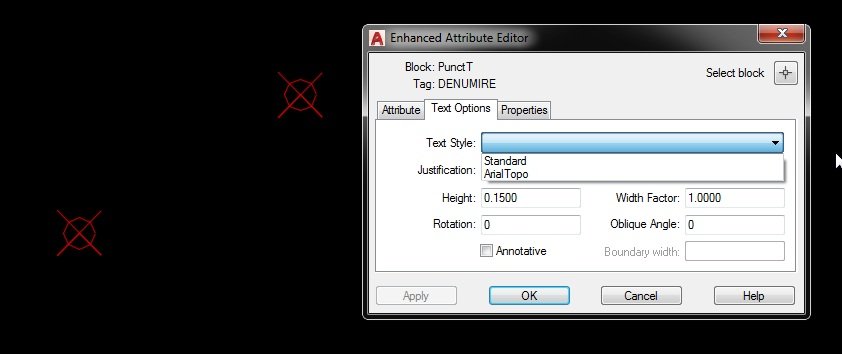

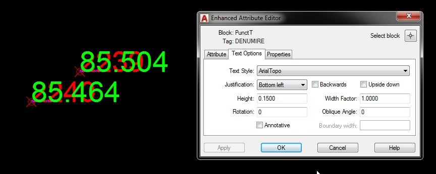

Costinbos77 Posted November 20, 2014 Author Posted November 20, 2014 Very interesting! I defined block with attributes by DXF code . I set the option vla-Put-LockPosition through Visual Lisp. (setq blockP (vla-Item Blocks "PunctT") ) (forEach e '(3 4 5 6) (if (vlax-Property-Available-P (setq attO (vla-Item blockP e)) "LockPosition") (vla-Put-LockPosition attO :vlax-True) (alert "No !") ) ) ;_ end of f But all the blocks inserted by the program are not LockPosition. Only the inserted manually. But if it explodes blocks that seem to not be blocked, it is found that the attributes are locked (LockPosition = Yes). Very strange! Attributes Block 2.dwg Quote
hanhphuc Posted November 21, 2014 Posted November 21, 2014 Very interesting! But if it explodes blocks that seem to not be blocked, it is found that the attributes are locked (LockPosition = Yes). Very strange! sorry costinbos77, we have no luck.. another word Attribute LockPosition is a Defination. - source from Help document - *AttributeReference = An object containing text that links to a block. Attribute object = An object appearing as a text string that describes the characteristics of an attribute reference. object.LockPosition Property Boolean; read-write for Attribute object, read only for *AttributeReference object Quote

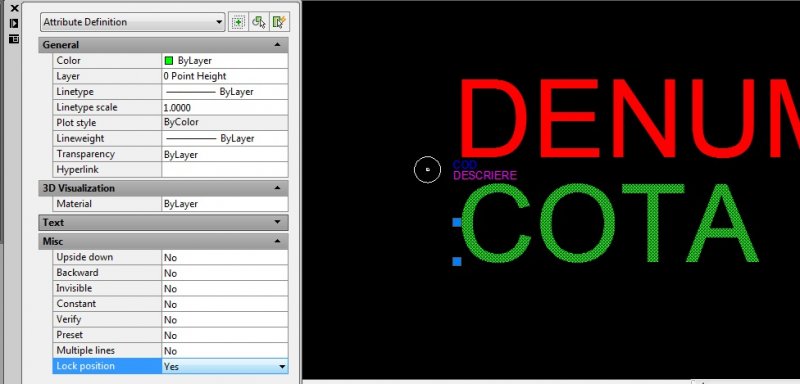

Costinbos77 Posted April 3, 2019 Author Posted April 3, 2019 (edited) Hello again , after a while . I find something , but not all that I need . So , to define a block with attributes and with the property LockPosition = On , using dxf codes , it is mandatory to put ALL the 100 codes , as : '(100 . "AcDbEntity") , '(100 . "AcDbText") , (100 . "AcDbAttributeDefinition") and to follow the sequence . The code '(280 . 1) or (vla-Put-LockPosition attO acLock) is not mandatory in the block definition , only if you want to be available for a manual insertion of the block as well . vla-Put-LockPosition it is an individual property for every Attribute , it is not a general property of the block with attributes . So , the same block can have few attributes with LockPosition = on and few attributes with LockPosition = off . But it is mandatory in the insertion definition , otherwise , the Attributes will not have LockPosition = on . (defun c:TestPP () (prinC "\n TestPP : V : 1 . 04 . 2019 ;") (if (tblSearch "Block" "PxT") (princ "\n Block Existed !") (progn ; Define Block (setVar "TextStyle" "Standard") (vl-CmdF "_.Purge" "_A" "" "_N") (command "_.Layer" "_N" "Name L" "_C" 1 "Name L" "") (if (tblSearch "Style" "ArialT") T (vl-CmdF "_.Style" "ArialT" "Arial.ttf" 0 1 0 "_N" "_N") ) ; (entMake '((0 . "BLOCK") (2 . "PxT") (70 . 2) (8 . "0") (10 0 0 0) (6 . "ByLayer") (62 . 256) (4 . "Made by Me")) ) ; end of e (entMake (list '(0 . "Circle") '(8 . "0") '(62 . 256) '(6 . "ByLayer") '(10 0 0 0) (cons 40 0.25) ) ) ; end of e (entMake (list '(0 . "AttDef") '(100 . "AcDbEntity") (cons 8 "0 Name") '(62 . 256) '(6 . "ByLayer") ;'(67 . 0) '(100 . "AcDbText") '(10 0 0 0) '(40 . 1.5) '(1 . "N") '(50 . 0) '(41 . 1) '(51 . 0) '(7 . "ArialT") '(71 . 0) '(72 . 0) '(11 0.5 +1.0 0) '(210 0.0 0.0 1.0) '(100 . "AcDbAttributeDefinition") '(280 . 0) '(3 . "Point Name") '(2 . "NAME") '(70 . 0) '(73 . 0) '(74 . 2) '(280 . 1) ) ) ; end of e '(100 . "AcDbXrecord") (entMake '((0 . "EndBlk") (8 . "0")) ) ; end of e (prinC "\n Block with Attributes DEFINED : PxT ;") ; end of p ) ; else ) ; if (setq i 0) (repeat 10 ; Inserting 10 Blocks with Attribute (entMake (list '(0 . "Insert") '(2 . "PxT") '(8 . "0") '(66 . 1) (cons 10 (trans (list i i i) 1 0)) '(50 . 0) '(41 . 1.0) '(42 . 1.0) '(43 . 1.0)) ) ; inserare Bloc (entMake (list '(0 . "ATTRIB") '(100 . "AcDbEntity") '(8 . "Name L") '(67 . 0) ;'(6 . "ByLayer") ;'(62 . 256) '(67 . 0) ;0 = MSpace ; '(100 . "AcDbText") (list 10 i i i) '(40 . 1) (cons 1 (ItoA i)) '(50 . 0) '(41 . 1.0) '(51 . 0.0) '(7 . "ArialT") '(71 . 0) (cons 72 0) (cons 11 (trans (list i i i) 1 0)) ;'(210 0.0 0.0 1.0) '(100 . "AcDbAttribute") '(280 . 0) '(2 . "NAME") '(70 . 0) '(73 . 0) (cons 74 2) '(280 . 1) ) ) ; set Attribute (entMake '((0 . "SeqEnd") (8 . "0")) ) ; End Insert Block ! (setq i (1+ i)) ) ; r (prinC (strCat "\n Inserted : " (ItoA i) " ;")) (prinC "\n TestPP : END ;") (prinC) ) ; defun And this property LockPosition , can't be changed with visual lisp for inserted blocks , only for the definition of a block : (vla-Put-LockPosition atV :vlax-True) ; is not working for insertion only for DEFINITION !!! (vlax-dump-object a1V T) ; IAcadAttributeReference: AutoCAD Attribute Reference Interface ; Property values: ; Alignment = 8 ; Application (RO) = #<VLA-OBJECT IAcadApplication 000000013f6551a8> ; Backward = 0 ; Constant (RO) = 0 ; Document (RO) = #<VLA-OBJECT IAcadDocument 00000000412b9318> ; EntityTransparency = "ByLayer" ; FieldLength = 0 ; Handle (RO) = "1256" ; HasExtensionDictionary (RO) = 0 ; Height = 0.3 ; Hyperlinks (RO) = #<VLA-OBJECT IAcadHyperlinks 00000000342a6cd8> ; InsertionPoint = (532320.0 181410.0 0.0) ; Invisible = 0 ; Layer = "0 Name" ; Linetype = "ByLayer" ; LinetypeScale = 1.0 ; Lineweight = -1 ; LockPosition (RO) = 0 ; Material = "ByLayer" ; MTextAttribute = 0 ; MTextAttributeContent = "" ; MTextBoundaryWidth = 0.0 ; MTextDrawingDirection = 5 ; Normal = (0.0 0.0 1.0) ; ObjectID (RO) = 43 ; ObjectName (RO) = "AcDbAttribute" ; ObliqueAngle = 0.0 ; OwnerID (RO) = 44 ; PlotStyleName = "ByLayer" ; Rotation = 0.0 ; ScaleFactor = 1.0 ; StyleName = "ArialT" ; TagString = "NAME" ; TextAlignmentPoint = (532321.0 181410.0 0.0) ; TextGenerationFlag = 0 ; TextString = "1000" ; Thickness = 0.0 ; TrueColor = #<VLA-OBJECT IAcadAcCmColor 00000000342a6d90> ; UpsideDown = 0 ; Visible = -1 ; Methods supported: ; ArrayPolar (3) Because : LockPosition (RO) = 0 ; The problem is now , if I delete all the contain and PURGE the dwg file , if i am repeating to define an insert my block with attributes Pxt , the TaxtStyle ArialT is creating a problem , and can't be used by the block . Pictures attached : The TextStyle ArialT it is available , but not set on the attributes . If I save this drawing and reopen it , the points are looking like this : The TextStyle ArialTopo is coming Active (as in the definition of the block ) , but all the attributes have the same Justification = Bottom Left . So , the problem is the insertion ( cod 72 and 74 ) or TextStyle definition ? If I keep the TextStyle ArialTopo preserved in the drawing , as current Text Style or used somewhere else , are NO problems . Any idea ? I create TestPP for testing . Edited April 5, 2019 by Costinbos77 Quote
