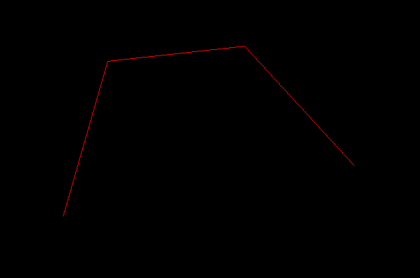

Is there any lisp that could change the radius of polyline to zero.

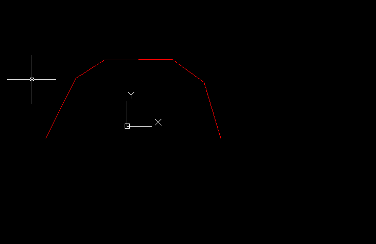

Hi
The decurve option flattens the curve only.
If possible, when I select the polyline, it should ask the user to specify the radius of all the curves in a polyline.

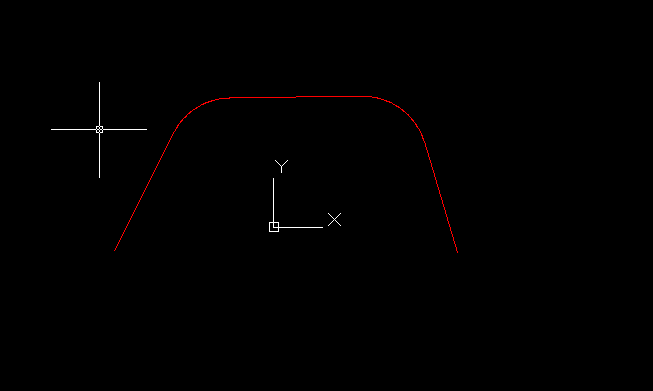

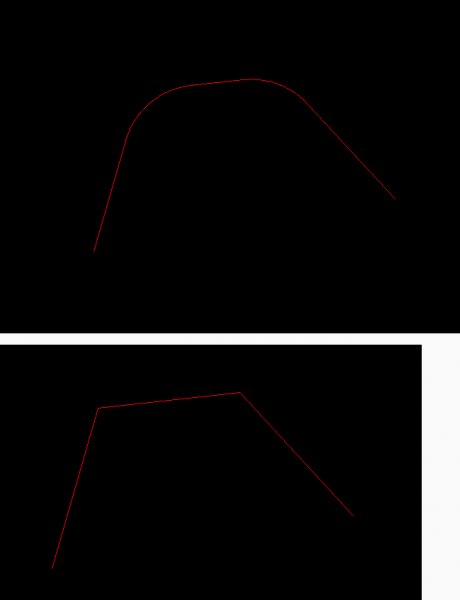

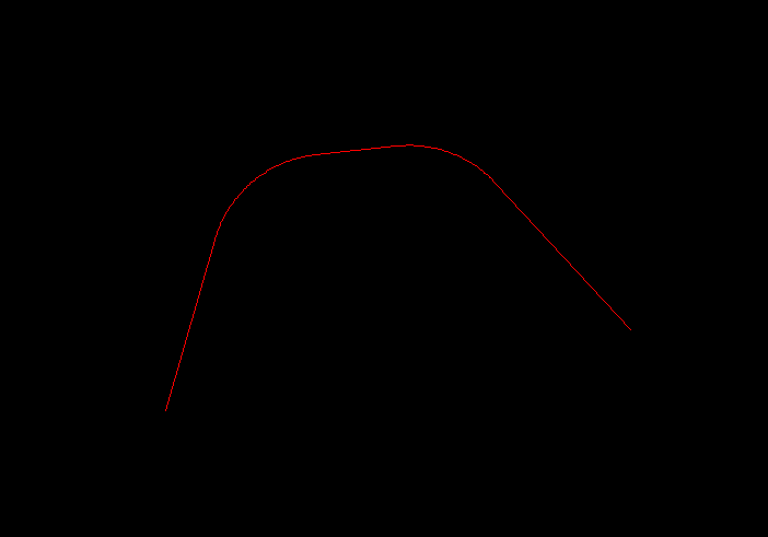

Here's what I've got using the pedit with its decurve option.
before the pedit command (decurve option)
after the pedit command (decurve option)
Alternatively try to use FILLET with Polyline option and Radius set to 0.

That's what I'm doing right now but it's take time if I'm working with very long polyline with hundreds of curve.

Hi tharwat..
The result is the same with Mircea's suggestion using the pedit with its decurve option. Its just flattened the curve in a polyline.

Hi tharwat
You might be confused with what I want to achieve.
The lisp should do something like this on the image below.

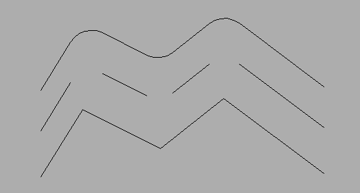

Hi
here's what I've written but I want to trim the red line that overlapped on the white line showing only the redlines that extended outside the curves.

Hi Lee
your version is much faster than mine.:thumbsup:
Is it possible to draw only the lines outside the arcs or remove the lines that overlapped on the original polyline?
Excellent, thanks :)
The program will recreate the polyline with all arc segments removed & replaced with linear segments, therefore, you can delete the original polyline if desired (or this deletion can easily be added to the code).
Lee
hi lee
i only want to removed the straight line that overlapped to the original polyline
